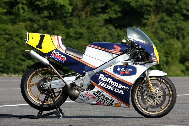

… In a nutshell I want to fit R5K high sweep pipes to my R4 to make it look more like the works replica it was (loosely) based upon
gp500-nsr500-1988-4

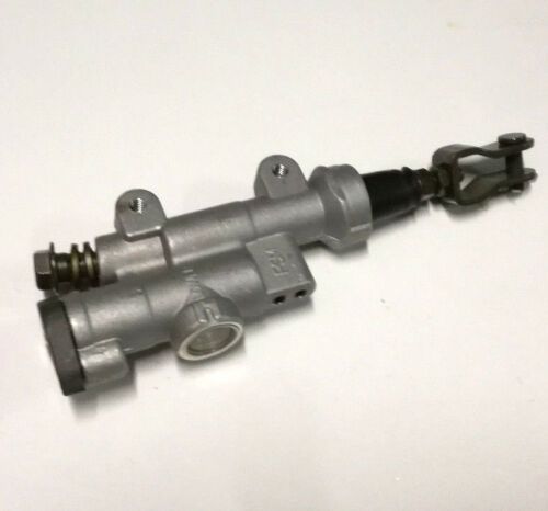

Or do folk go the other way and do a straight swap and simply secure the electrics in place with cable ties and perhaps upgrade to one of these piggy back jobs to solve the brake problem, this seems to be the quick / dirty option
Back_Brake_reso
