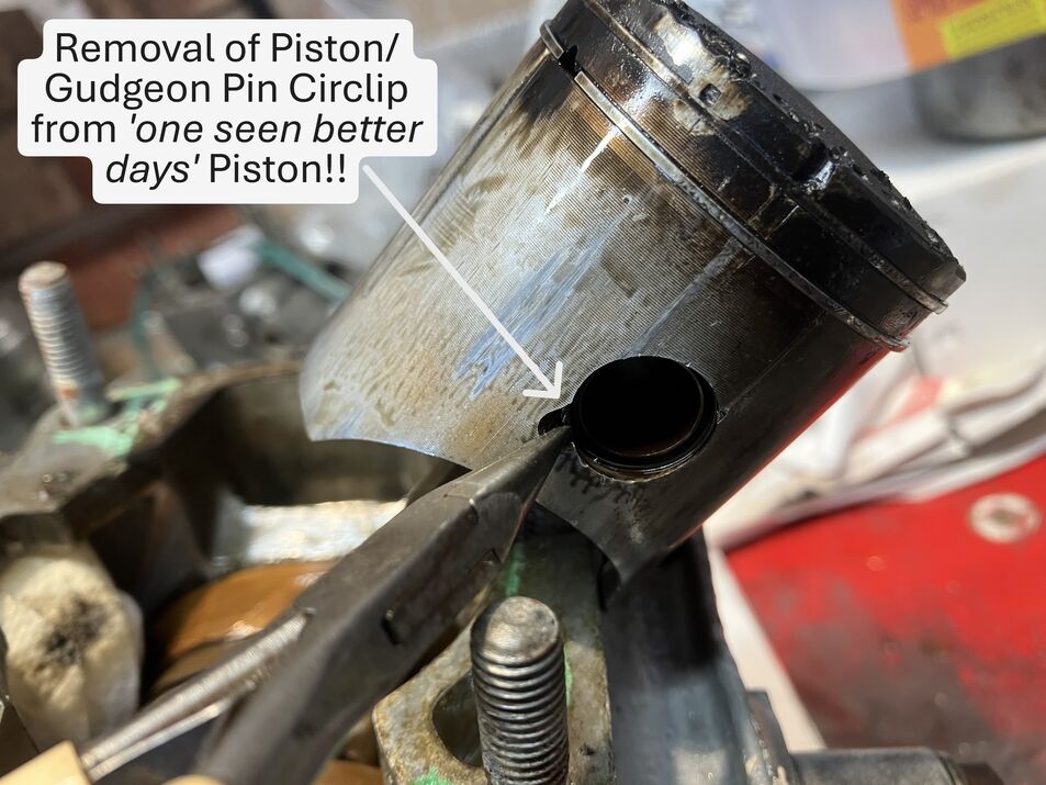

Using a very small set of fine Pliers, Circlip was removed on the one side.

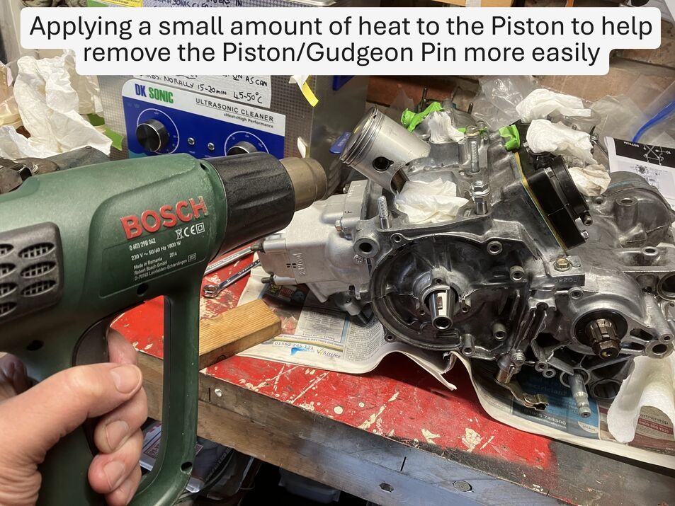

Image taken from the later rebuild stage, apply a little heat to the Piston makes removing the, Gudgeon Pin/Wrist Pin/Piston Pin or whatever it’s called these days, somewhat a little easier.
