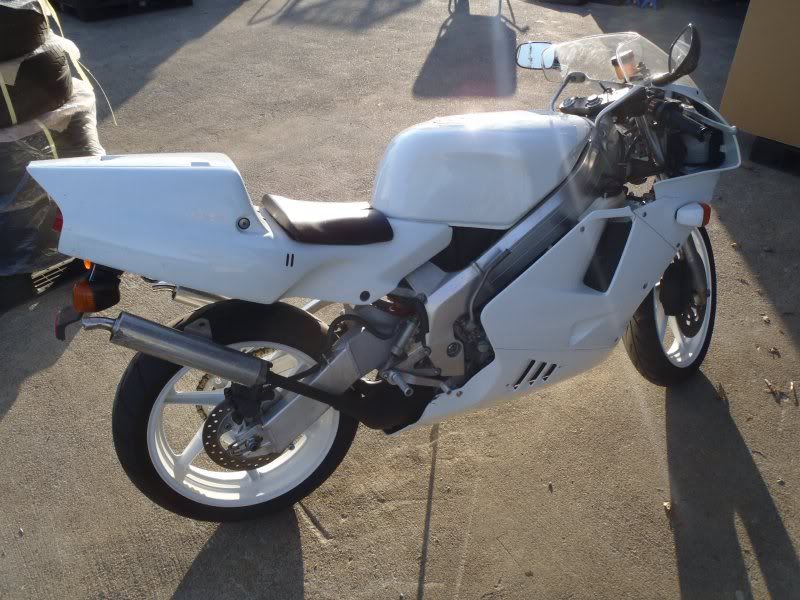

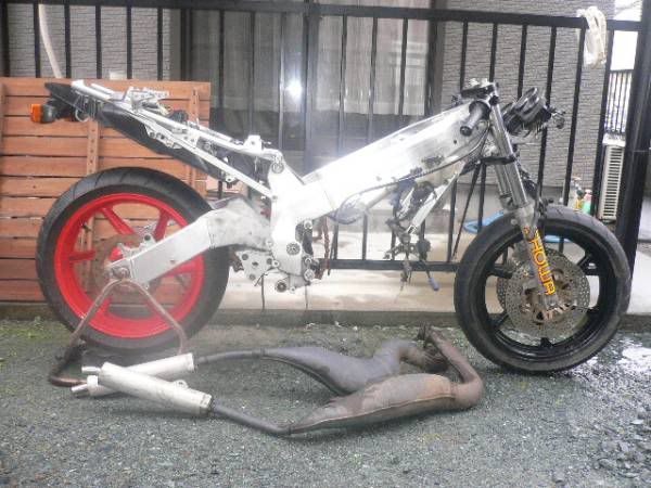

New to the forum and acquiring an MC21 for a bit of a project to turn into a track only beast for next year.

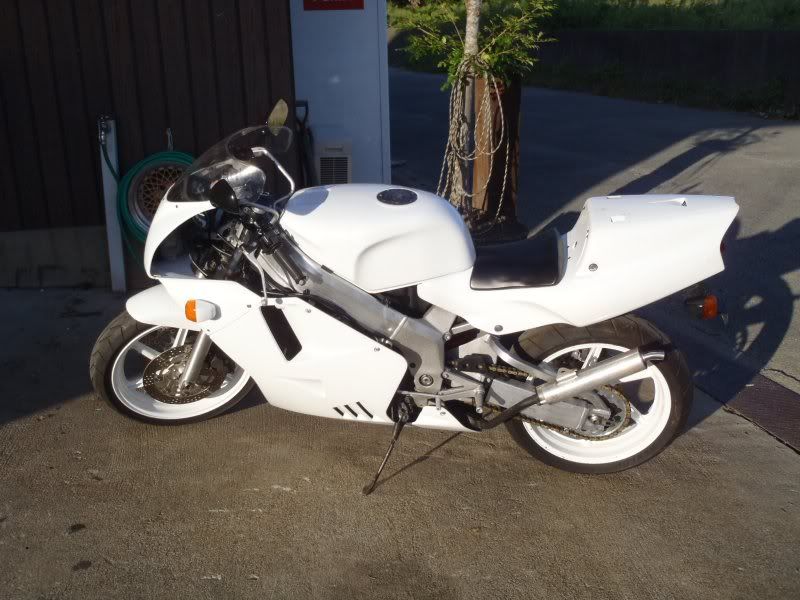

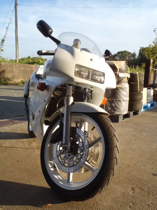

So far I have bought a bike (R model), a spare rolling chassis (SE model), and a tonne of Tyga bits to make it pretty and pretty fast.
The bike is coming from Japan, bought off the auctions there. It is still 6 weeks away but i'm already champing at the bit to get things underway.
Here's the bike:

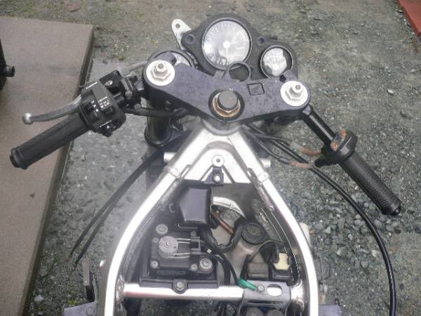

And here's the spare chassis (with bonus electrics):

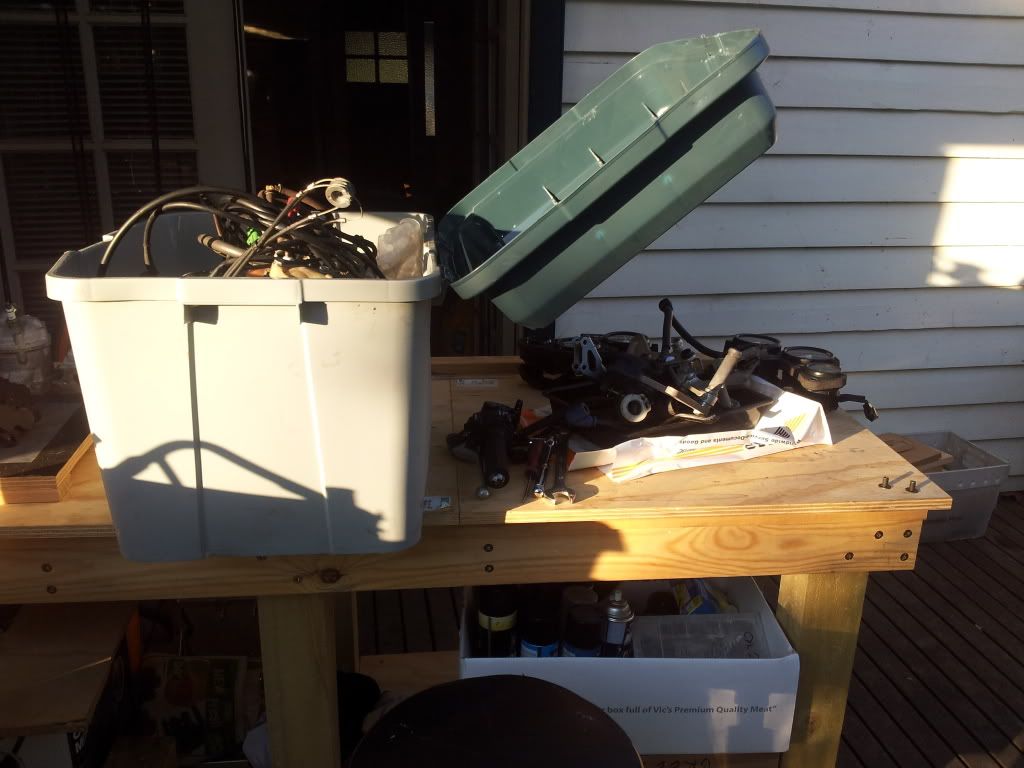

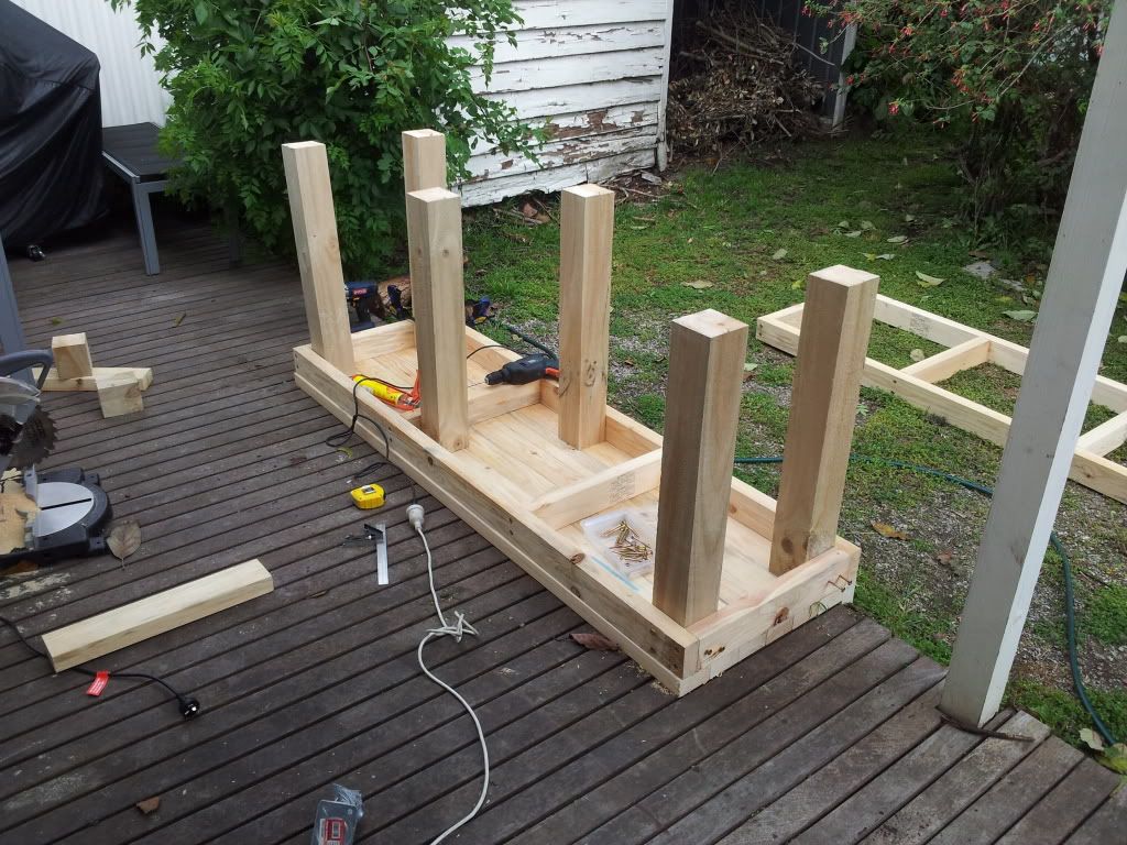

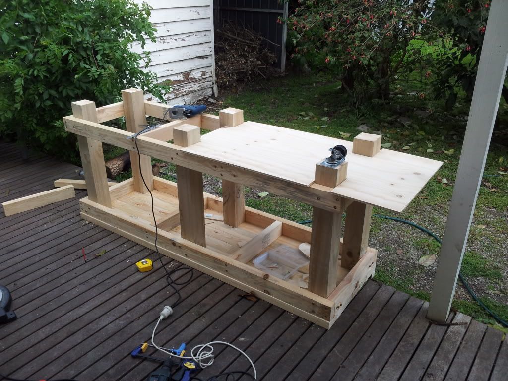

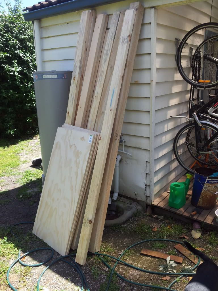

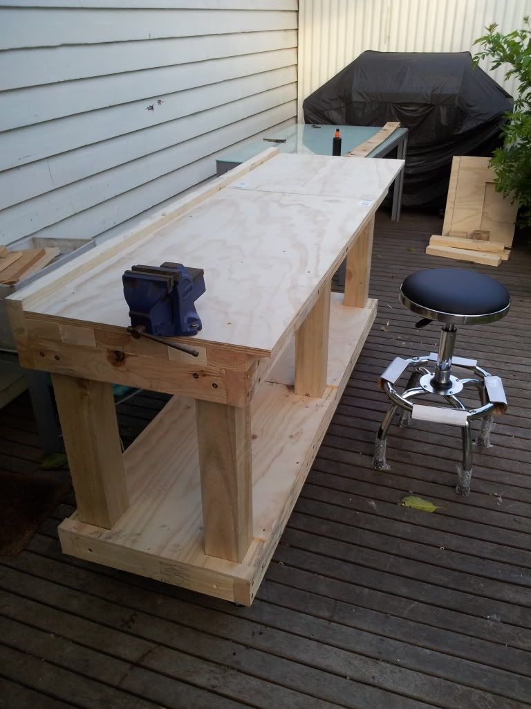

So my first job was to build a bench. Job jobbed. Only took 3/4's of the day. I was surprised, it went together easily.
I turned this:
Into this:
[IMG]http://i261.photobucket.com/albums/ii59/breeseg/2011-10-29132054.jpg[IMG]
into this:
and finally, into this:
[IMG]http://i261.photobucket.com/albums/ii59/breeseg/2011-10-29190903.jpg[IMG]
[IMG]http://i261.photobucket.com/albums/ii59/breeseg/2011-10-29190916.jpg[IMG]
Designed to fit in my garden shed when not in use, hence the castors to get it there. A friend of mine is going to bend me some stainless steel to put on part of the top. Handy for working on some bits and pieces as it is easier to keep clean (like working on suspension etc).
Next job is to start surfance prep on the fibreglass (and seal in the belly pan for racing). Knowing the quality of tyga output, prep won't take long. Chances are I will have the body work well and truly done before the bike is half way here.

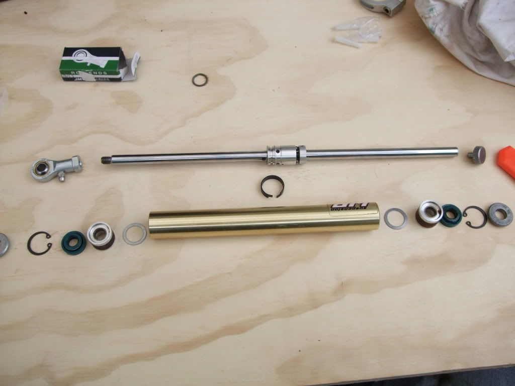

I rebuilt my steering damper today, I wasn't able to get new seals, so reused the old ones and used fresh 2.5W oil. It's cured the inconsistent movement, but will have to wait and see how it goes with the reused seals. It may only be temporary (which means i'll be forced to invest in a hyper pro - how terrible).
I was able to find seals with the same inner and outer Diameter, unfortunately they were just too thick. (New on the left, old on the right)

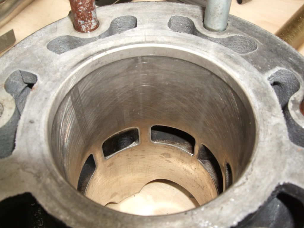

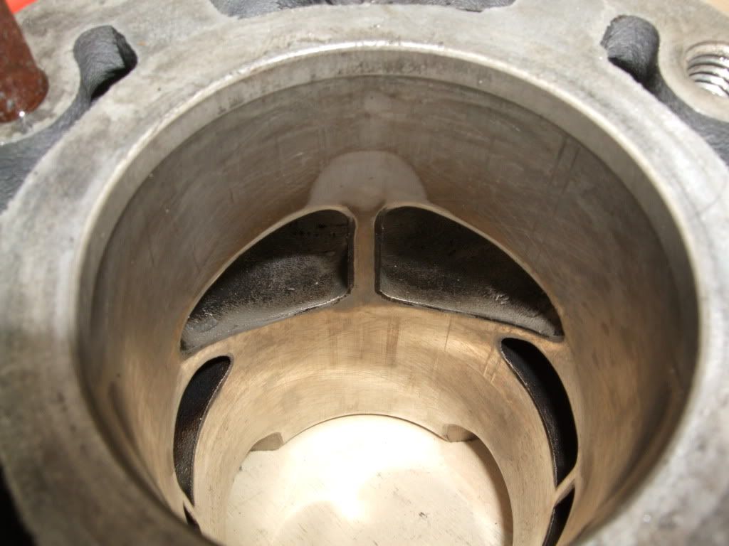

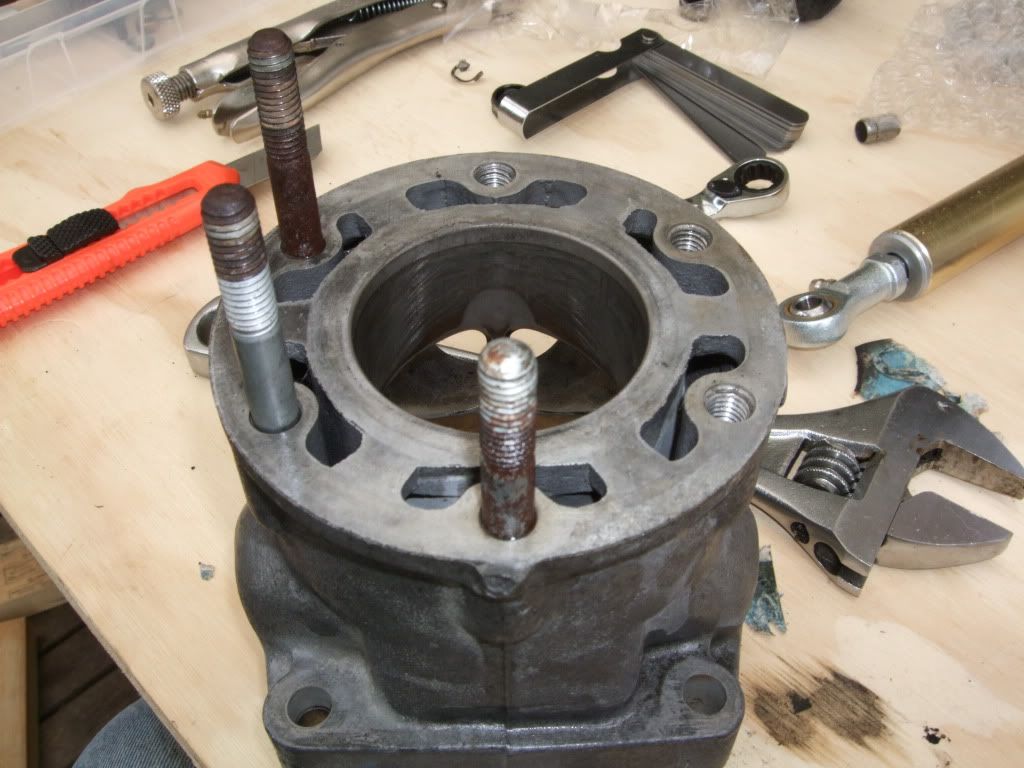

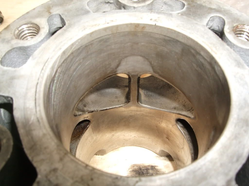

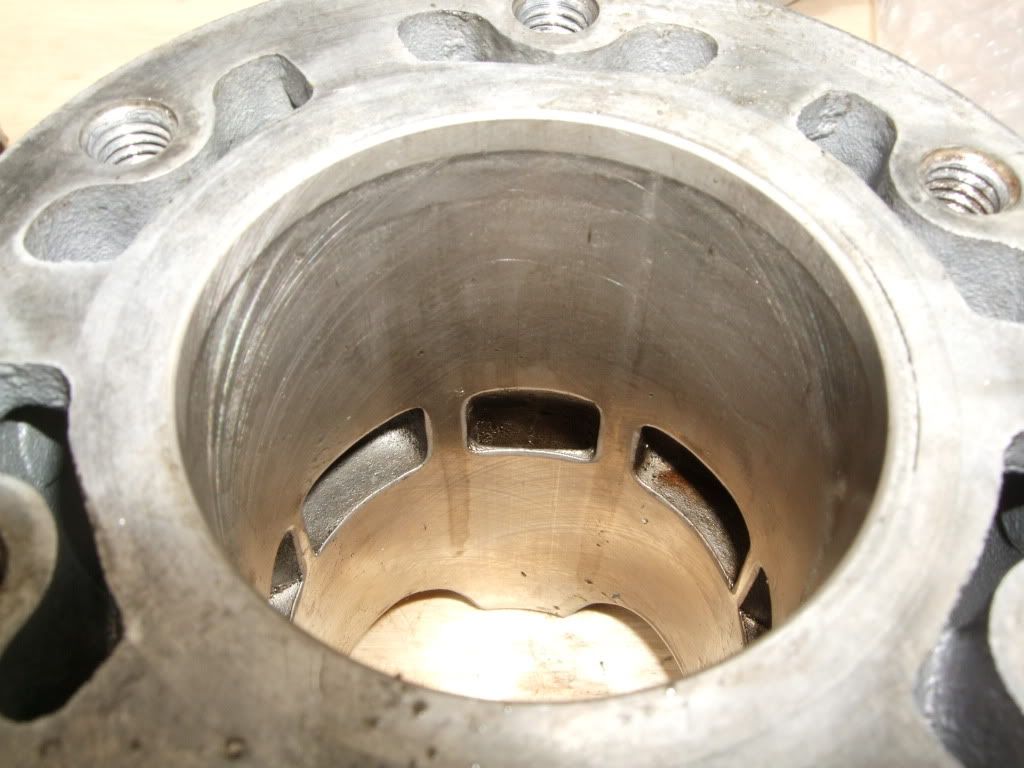

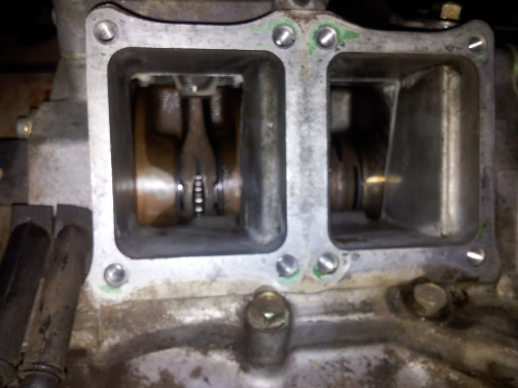

And to keep myself busy I removed the studs and power valves from the cylinders, fairly easy job, I expected them to be much more stubborn. I measure the ring gaps on the piston/rings that came out of the cylinders and got .045-0.5mm on the top ring and 0.40-0.45 on the bottom ring. Cylinders themselves look to be in pretty good nick, and i will prep these to go back in (but i'll wait until i've compared them to the cylinders on the bike when it arrives before assembling the power valves).
Cyl 1:
Cyl 2:
Questions:
What do you think of the cylinder condition from the pictures, and
What is the best way to clean up the valves space inside the cylinder (soup)?[/img]

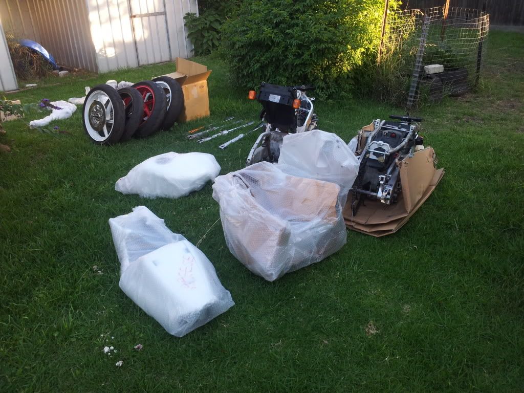

So the bike finally arrived. Just in time for Christmas, just as well, i've 10 days off so plenty of time to build an engine assuming I don't discover I need to buy a crank or something.
So all this will eventually become a bike:

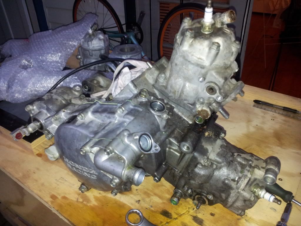

After unpacking I have stripped the engine of ancillary naff so I can clean it before complete dissassembly.
Learnt some things about the bike. It is an ex racer - various bolts are drilled for lock wire. The spare chassis I got is quite rough, the fork tubes will not be useable, but I got those for the internals anyway.
The importers also snapped a couple of the carb joints so they will need replacing at some stage.
Crank web has a stain on it from what appears to be rust that has been removed.
So first job is the engine. Clean, dismantle, inspect, tidy the cases inside with the die grinder, reassemble and put away for when the chassis is ready to meet it....
Can't wait...
I now have a shed load of crappola up for grabs if anyone needs any road going stuff. Everything from fairings, chambers, straight subframes, to a full lock set with key.

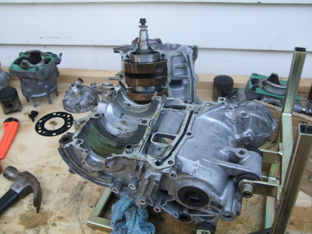

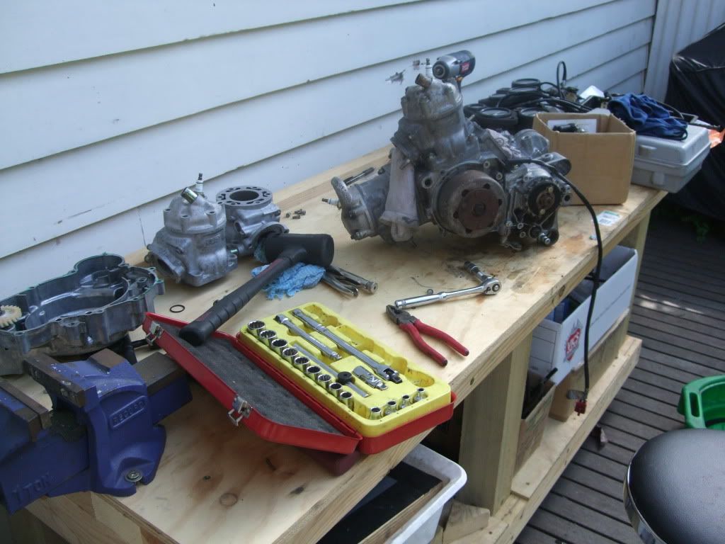

Preparing for complete disassembly...
It all came apart quite easily....

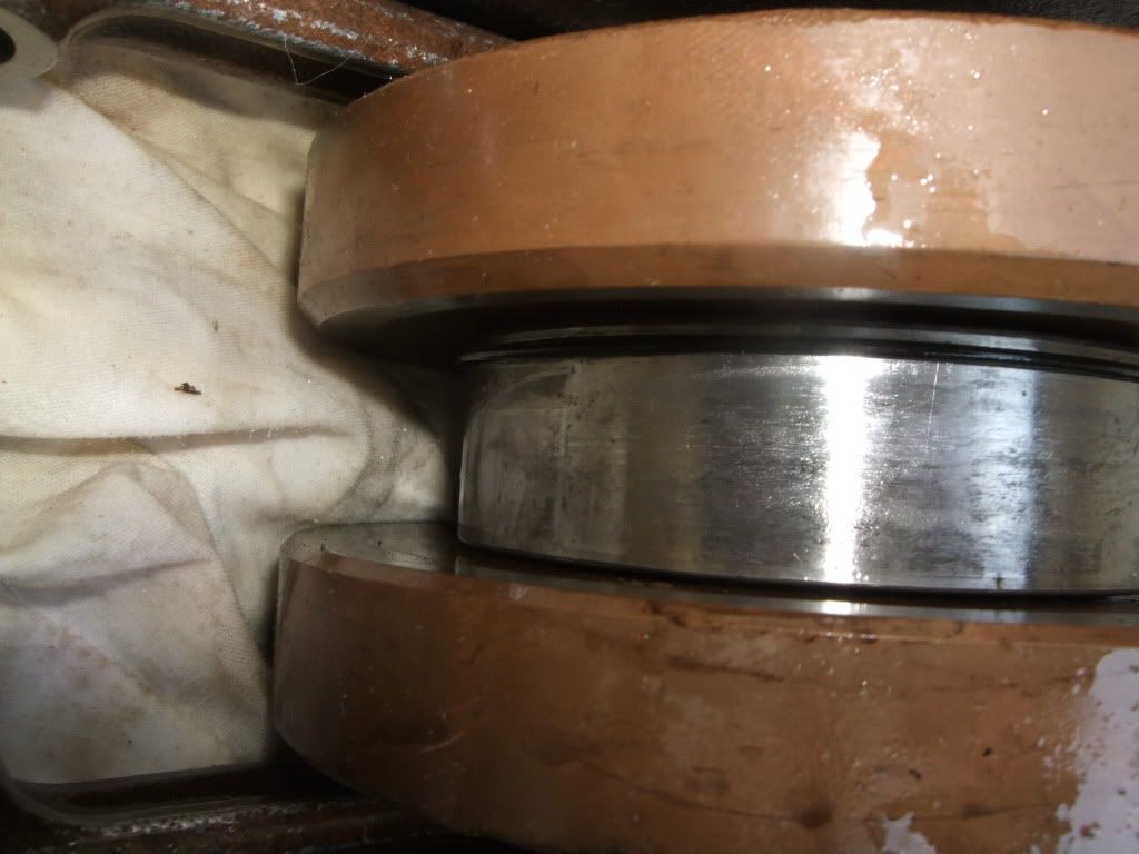

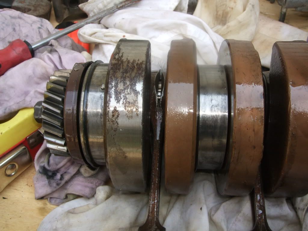

Here's a pic of the water damage on the crank webbing. I'm guessing this engine was left idle for a period of time.
The thin rubber o-ring in on the centre has been quite badly stretched, will this be a problem? (I can see it at least being a PITA to reassemble)
Checked the crank condition against the specs listed elsewhere and the crank/conrod gaps are .6 and .55 so well within tolerance.
My only real concern at this stage is the water damage to the webbing, and the bearing condition. They feel okay....but....
Clutch looks near brand new, basket included. Everything else looks to be in great knick.
Next step is to clean the engine and cases with the soda blaster...I reckon that will be enough for today. While I research the centre o ring on the crank...
