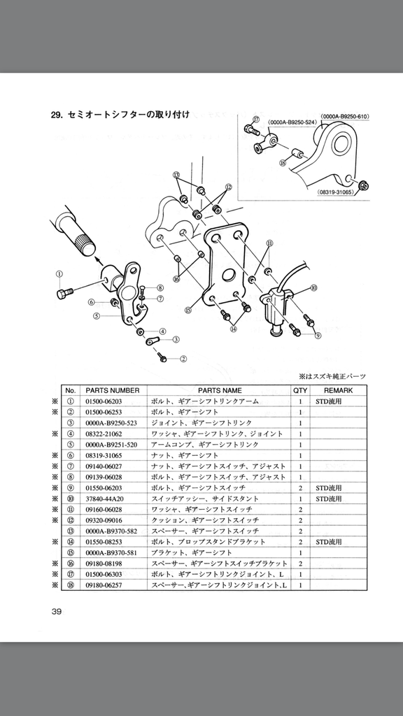

I was reading an article about the 500 Suzuki raced by Kevin Schwantz back in the day and noted that this factory bike used the standard side stand switch from the VJ range as an automatic " kill switch " mounted near the gearchange linkage and this killed the motor momentarily and quicker clutchless changes were made by this very simple mod .Im going to fit one on my NSR and report back >>>

The auto rimessa(Suzuki race parts ) vj23 have the same setup
