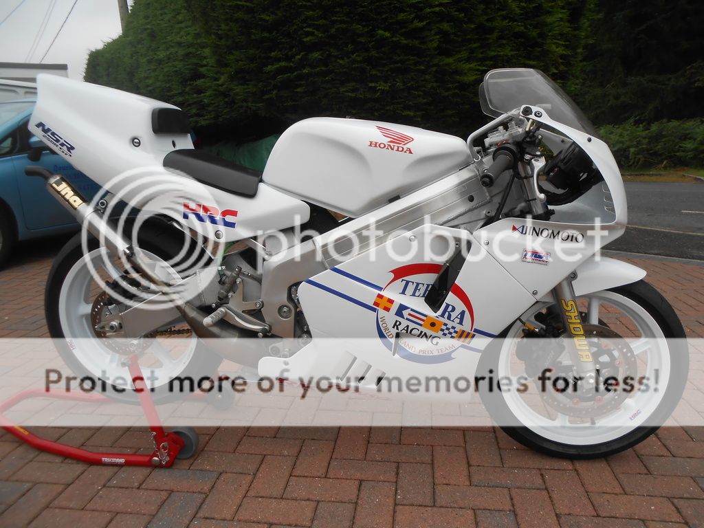

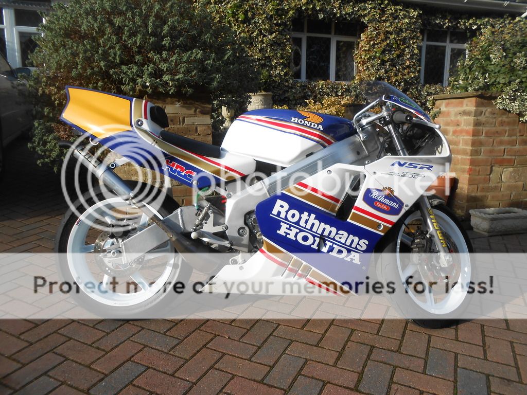

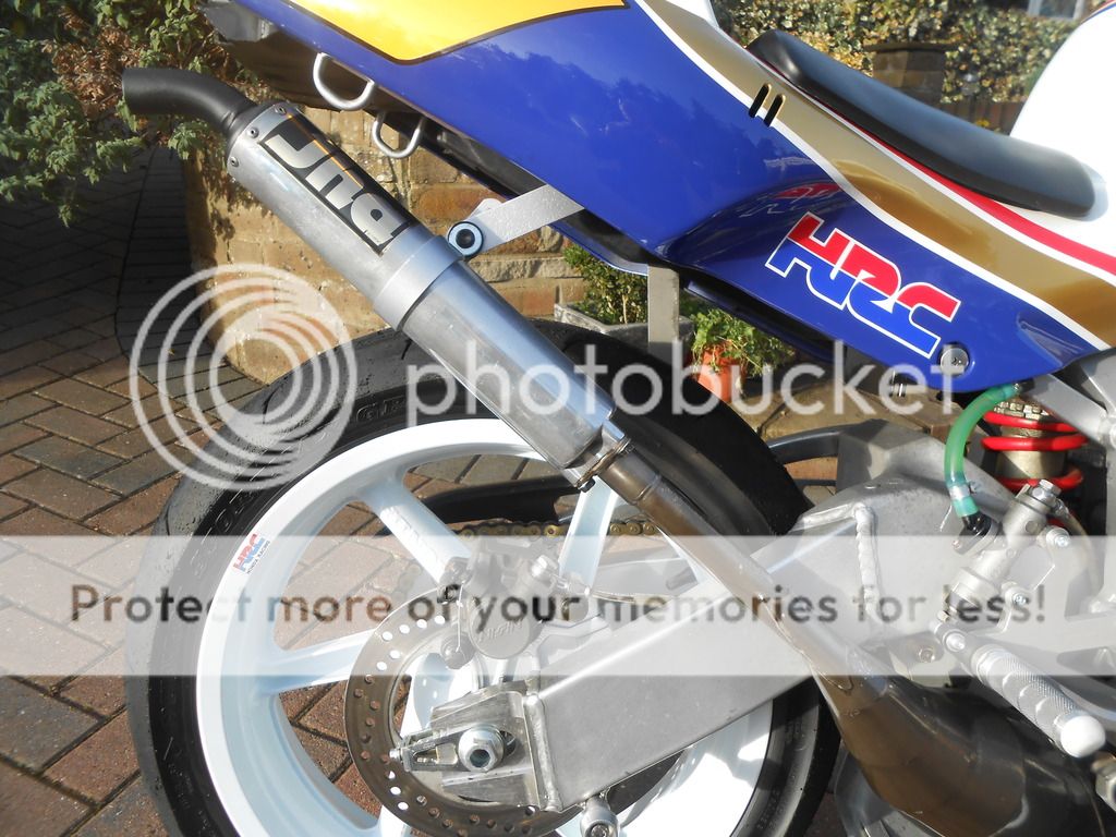

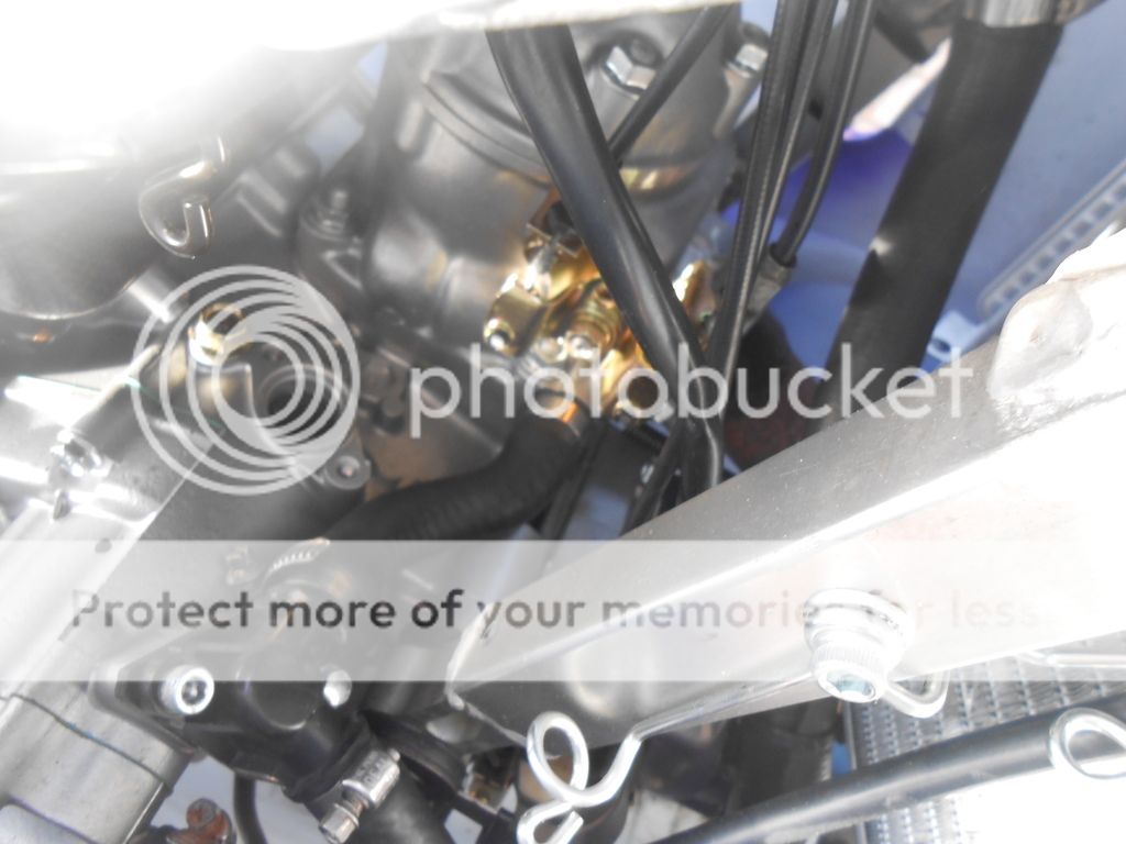

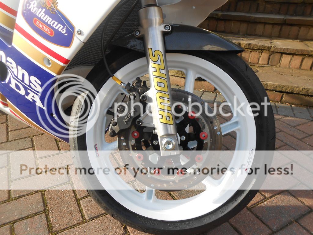

Hi there
I have been getting this 21 sorted over the last year as I want to preserve the Castrol bike and retire it from trackdays and use this,This has several nice bits on and it performs real well,The frame was sourced from a dealer from Ashbourne along with an old race engine from Japan,I stripped the motor to find a n F3 gear kit and 2 rear heads no oil pump or kickstart,I went through the motor vapour blasting and a full rebuild,I sourced a pair of F3 carbs,HRC loom,and box,carbon copy of HRC air box,K&N pod filters,MC 28 se forks and calipers EBC iron discs,RS 250 nf5 Magteks,JHA exhaust system,Coerce rearsets,and I prepared a race body kit in white but prefered my old Rothmans trackday kit,Ive got a nova and dating letter if ever someone wanted to reg it,
Looking forward to next spring to get a few trackdays in with Les
All the best,
jonmac
