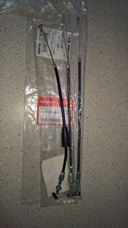

Tue Nov 27, 2018 6:14 pm » Post: #1 » Download Post
Just sorted another bit of my part jigsaw puzzle
MC18 2J & 5K short cables are 33cm.
MC21 is 34cm
Both of my right hand cables have a rubber boot
Both MC18 short cables are discontinued, but I've managed to source all 4 now
Posts: 12046
Thu Nov 29, 2018 2:31 am » Post: #2 » Download Post
Yep! It's important to have not only the correct cables, but also the correct pulleys, else you will either not get the required travel (RC Valve won't fully open), or it will strain against the roof/floor of the port, and likely burn out the PGM.
