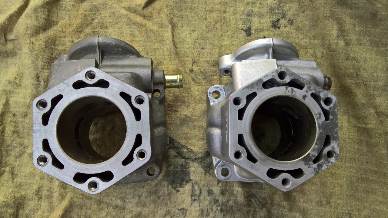

I bought this cylinder a while ago advertised as a new MC18 F3 cylinder.
I've had some previous confirmation that it's not, but can anyone confirm what it is for? Let me know there are any other views needed. I would like to sell it. The cylinder on the left is an MC18

Looks like mc16 to me Rob. What size is the exhaust port compared to the mc18 cylinder?

Fri Jul 26, 2019 2:41 pm » Post: #4 » Download Post
It could be MC16 F3. The exhaust port on the standard MC16 was quite narrow, the F3 is wider and much more like the later cylinders. Mine measures approx. 67mm at the widest point measured circumferentially.
Some pictures of mine. I thought I had a stock one to compare against but cant find it!

Fri Jul 26, 2019 5:48 pm » Post: #5 » Download Post
It measures about 40mm across the exhaust. I will sell as an MC16 cylinder
