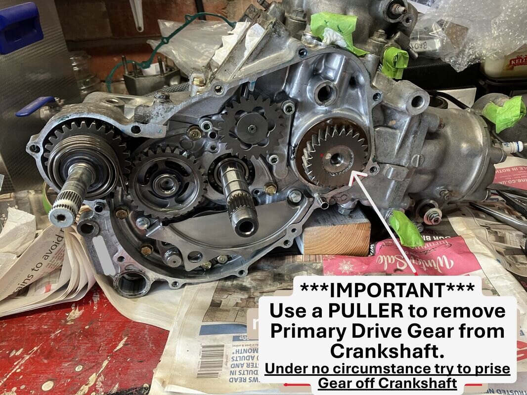

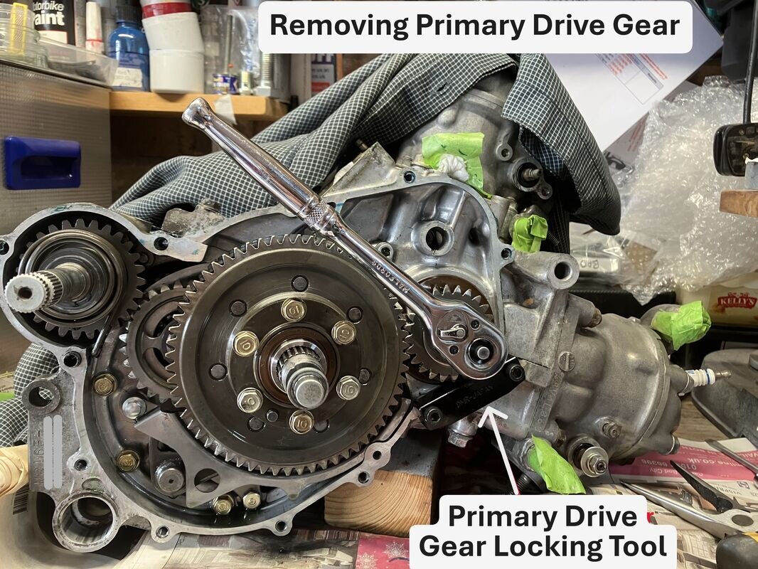

Primary Drive Gear Removal
This to be done in two stages, initially, using DMR-JAPAN Primary Gear Holder TL006 ( 2 Bolts securing it to the Crankcase ) to lock the Primary Drive Gear & undo its Bolt.
However, leave the Gear in place for the time being as it makes it a little easier to rotate the Crankshaft and get the Pistons in the right place to remove later on, unless of course you have removed the Cylinders beforehand.
The Clutch Primary Drive Gear was removed a little later on (not in these Images) and also the Kick Start Mechanism was removed before it fell out!!

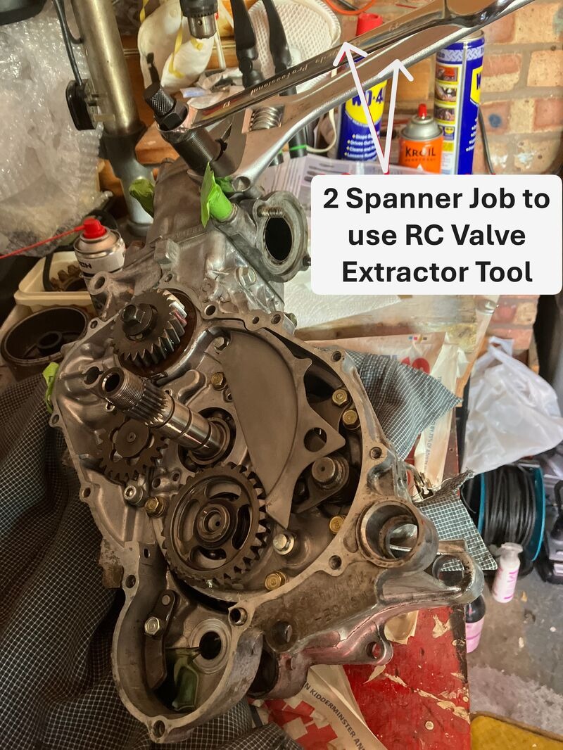

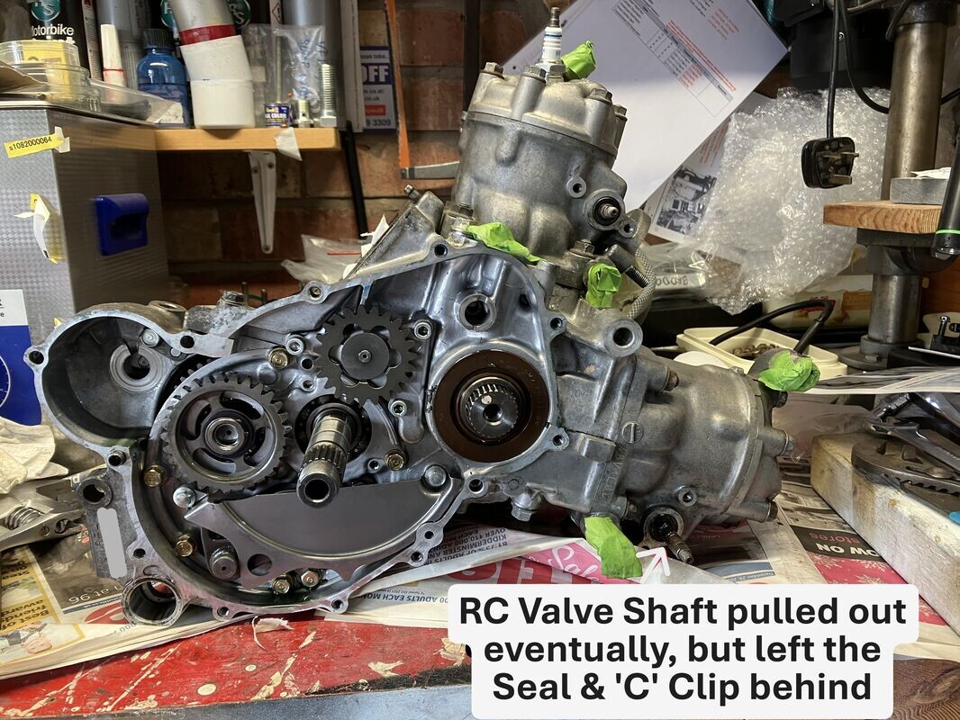

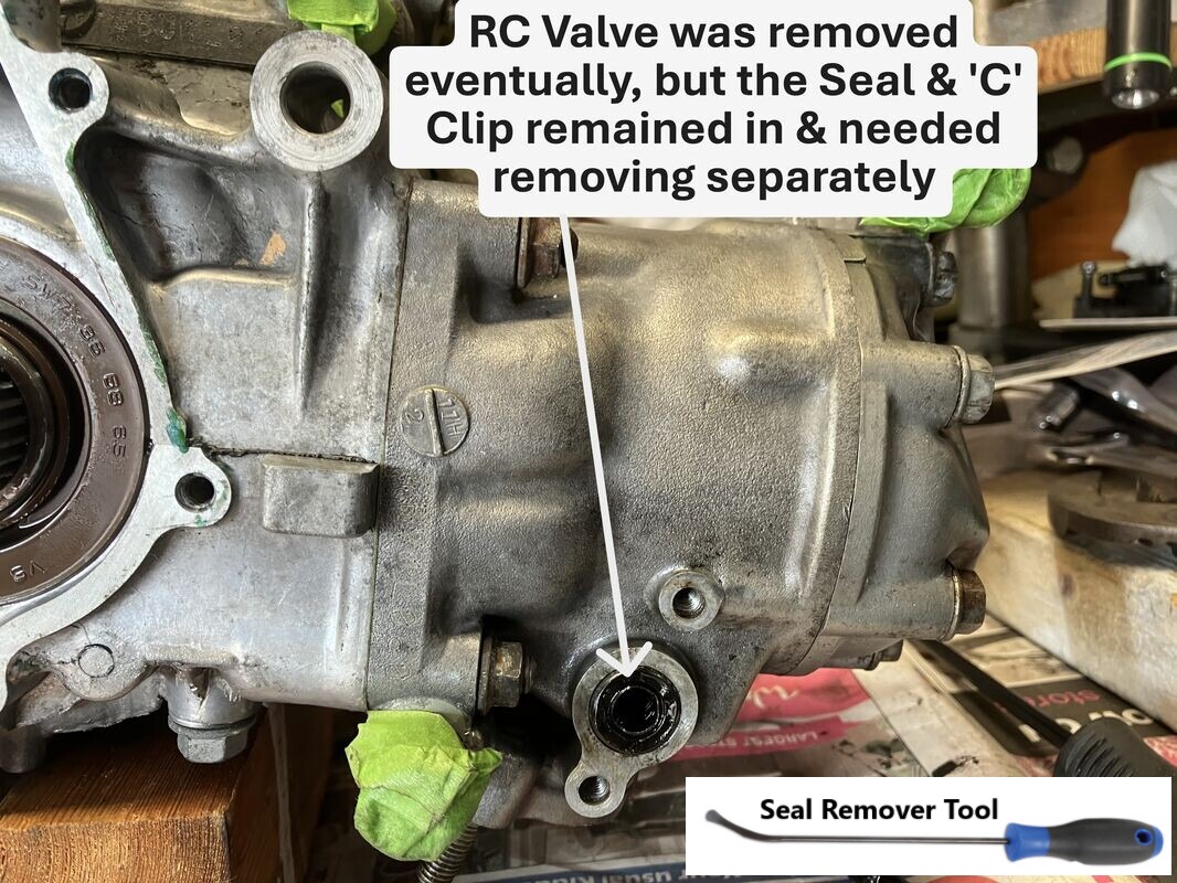

RC Valves Removal
Removed the RC valves while in situ to make like easier (If that ever happens!!).
The Cylinder & Cylinder Head Nuts were slackened off prior to RC Valve removal, you don’t need to do it this way round, just wanted to try out T2Racing special Cylinder Nut Tool to see if it worked without any issues LOL.
Probably didn't need to use the special Cylinder Nut Tool if I took the RC Valves out beforehand, but most probably will need during assembly as it's easier (well I think it is) to assemble the RC Valves whilst the Cylinder is on the Bench (well that's my excuse m'lud).
The RC Valves were sprayed with some KROIL penetrating oil thru the Exhaust Port and left overnight with the hope it would help the extraction process. However, it was still a struggle extracting the RC Valves as the Seals & ‘C’ Clips refused to budge & had to be extracted separately afterwards with my trusty Seal Remover Tool.

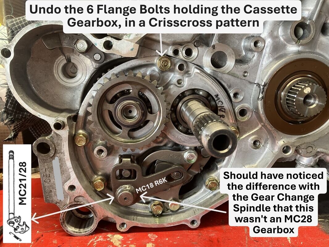

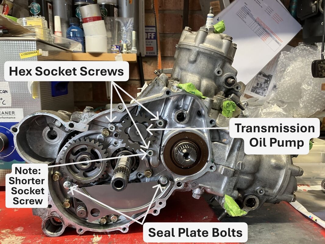

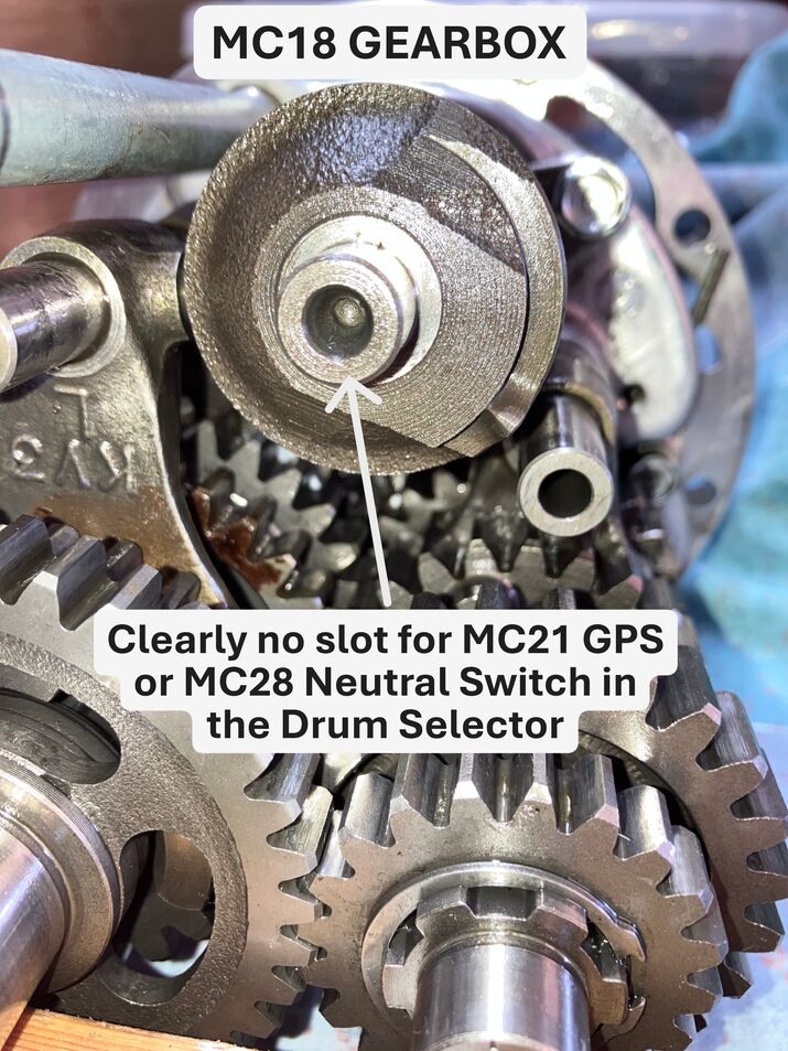

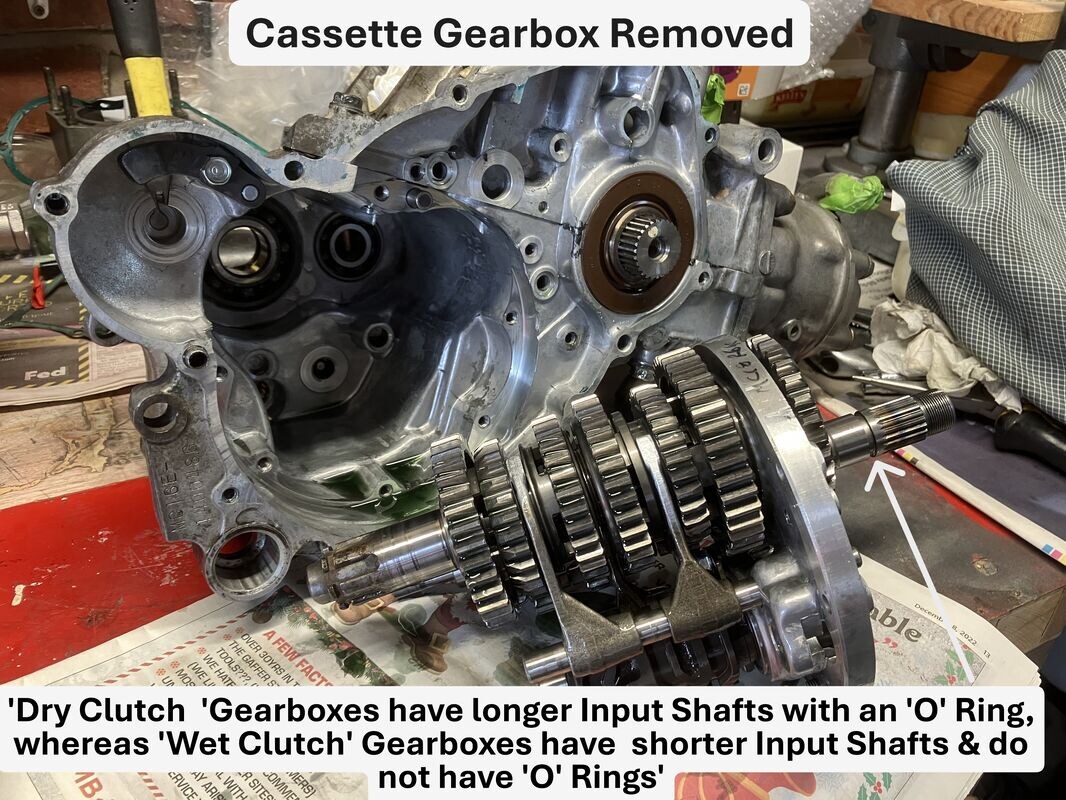

Gearbox Cassette Removal
Remove 2 Bolts holding the Seal Plate in front of the Cassette Gearbox & the 3 Hex Socket Screws holding the Transmission Oil Pump. Some heat (eg hot Air Gun) may need to be applied on the Transmission Oil Pump Hex Socket Screws as they have a Locking Agent on the threads.
(Note: (1) The Lower Screw is slightly shorter that the other 2. (2) There are 2 'O' Rings which will require replacing. (3) Do not lose the 2 Knock Pins used to locate the Transmission Oil Pump).
If you are not going to replace the Gearbox Output Oil Seal, wrap the Output Shaft with something like PTFE Tape, Cling Film etc.. to help protect the Seal when the Cassette Gearbox is removed.
Now remove the 6 Flange Bolts in a Crisscross pattern 2-3 steps & the Cassette Gearbox together with the Gear Change Spindle should just pull out easily.

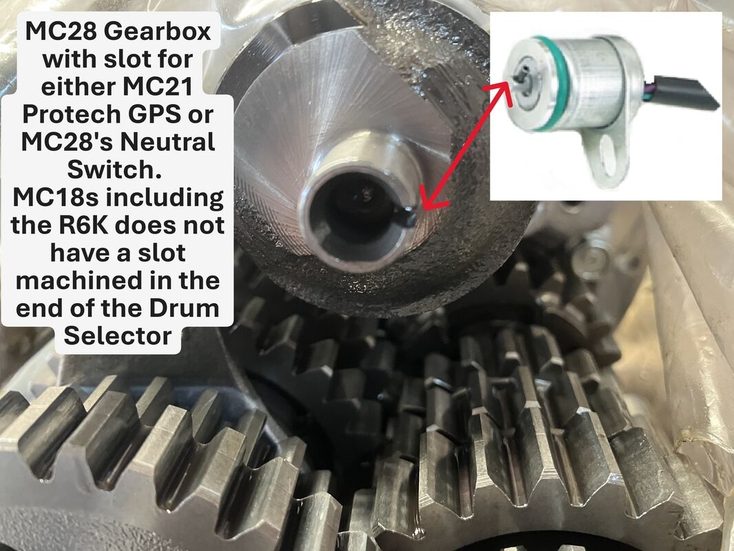

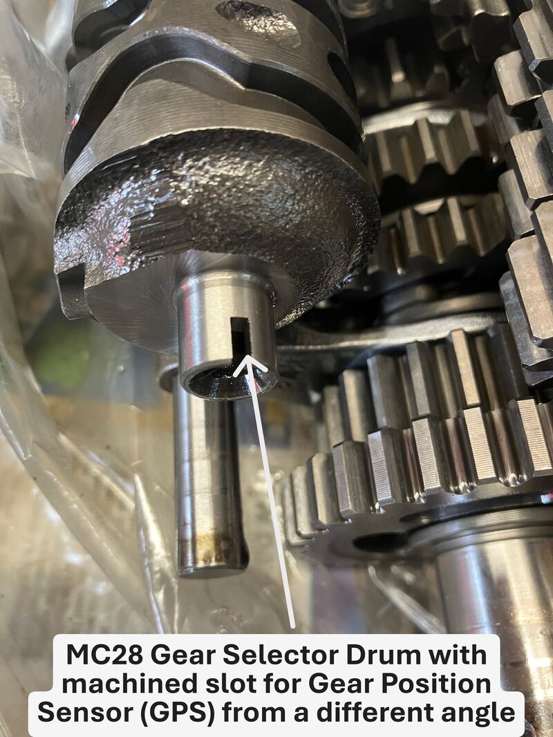

This is the point when I should have realised WHY the Neutral Light wouldn’t work (and never would have worked either). It wasn’t just the Gear Position Sensor (GPS) playing up, the end of the Gear Change Spindle was of the MC18 family & not MC21/28 (See 2nd image above).
Another big clue, when the Cassette Gearbox was out, was the lack of a slot in the end of the Drum Selector which the GPS slots into to give the position of the MC21 Gears & Neutral position for the MC28 (See image of MC21 GPS & MC28).
You can clearly see the difference between the ends of the MC28 (previous post) & this MC18 Drum Selector & why the Gear Position Sensor (GPS) just can't work.
Note: I will put some images on the difference between the MC18 & MC21/28 Switch posistions in the Crankcase later on.

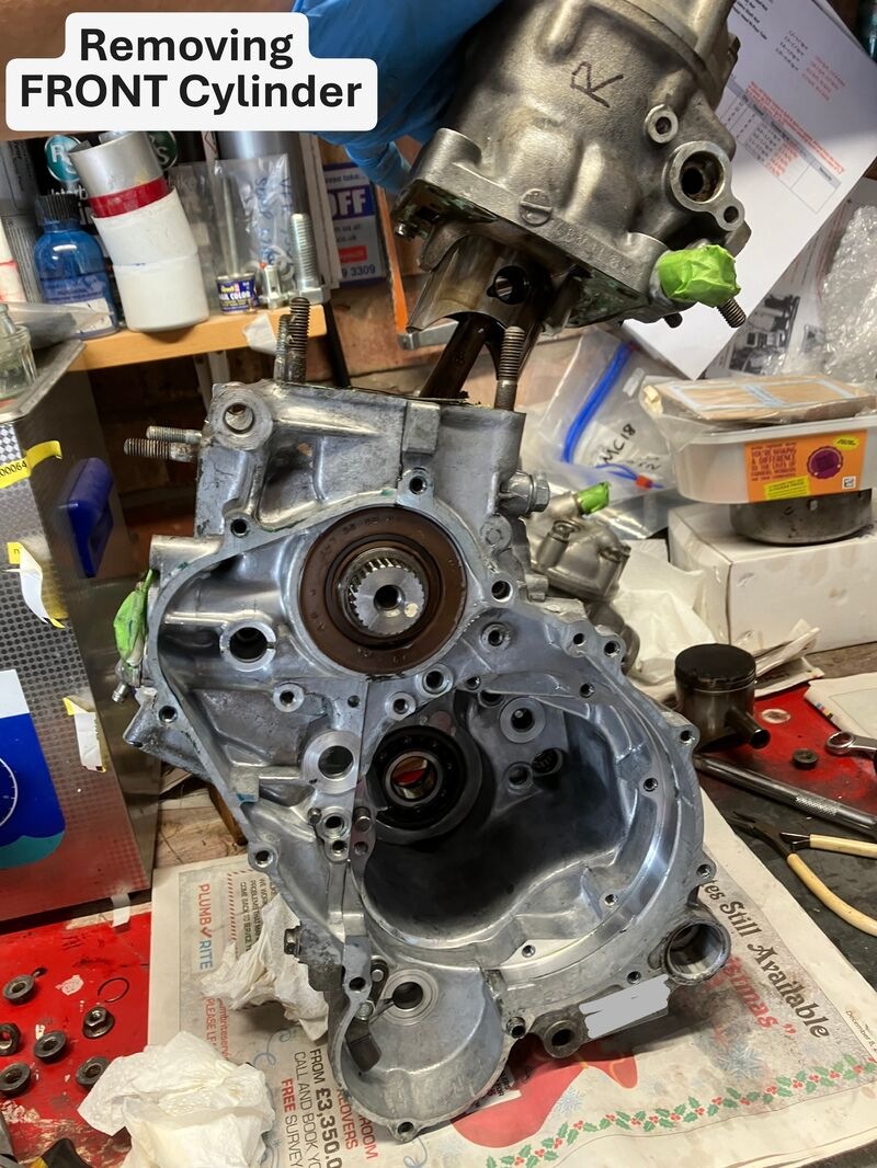

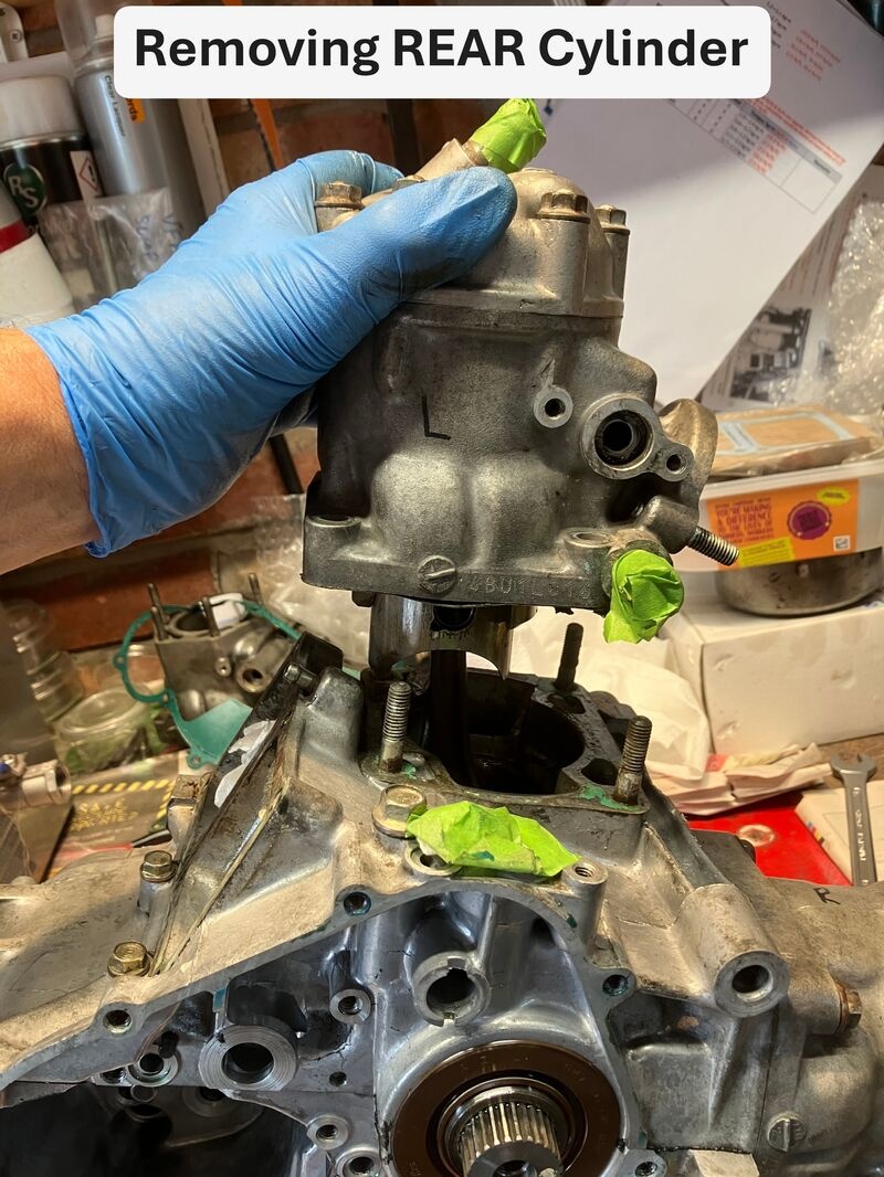

Remove Cylinder Head and Barrels
Remove the 4 Cylinder Nuts & tap Cylinder Barrel lightly with Rubber Mallet or something similar to dislodge it from the seal with the Crankcase.

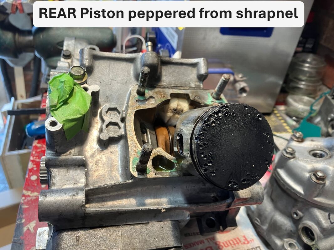

Rotate Crankshaft to push Piston to TDC and pull Cylinder Barrel (Rear Cylinder in image) upwards away from the Crankcase (support the Conrod by wrapping some Rag around it, yes I know, as you can see I didn’t!!) and away from the Piston.
Cylinder removed to reveal a moon landscape on Piston, something has gone terrible wrong in this Engine, no wonders it didn’t want to start very well!
Repeat above process on Front Cylinder. As you can see the Crankcase sits quite steadily in a vertical position.
The Cylinder Head nuts were slackened off beforehand so they can now be undone and the Heads removed. I didn’t bother removing the Heads as I was going to use MC18 Cylinder Barrels & Heads, although looking down the REAR Barrel revealed the Head was in a bit of a sorry state.
