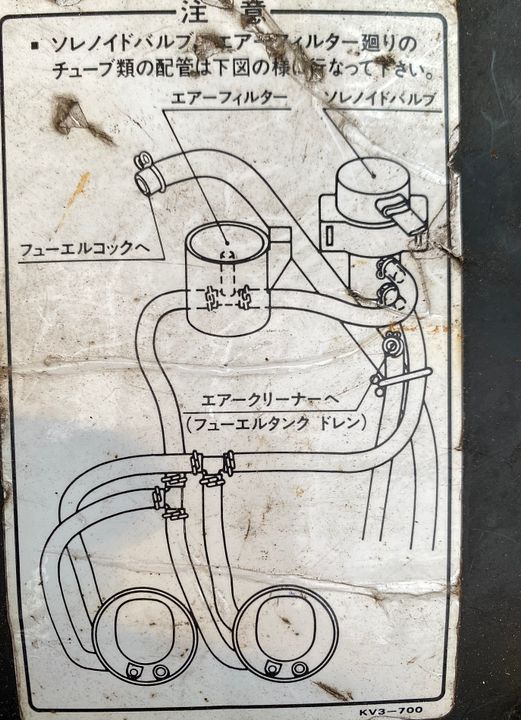

Hi
Not sure whether attached Diagram is useful other than rebuilding an R5K from boxes that were put away some 10+ years ago and now can't remember a flippin thing as to where things go.
I know there is a Diagram in the Manual, but found this useful.
Regards
Philip

Nice one
Just saved and printed that out - It will come in handy real soon even if its just to double check my work
R4J is different
