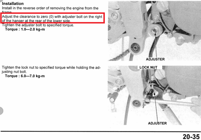

I've gotten the motor back into the frame but concerned about this gap on the lower right side mount.
I've installed the the outlined parts
Front engine mount: 36, 17, 13, 17, 5, 5, 17 13, 17, 31
Lower Rear engine mount: 36, 37, 6, 17, 21, 21, 17, 39
Upper Rear engine mount: 40, 17, 15, 17, 32
In the parts diagram, I'm not sure about part combinations (14,1Cool, (14, 19, 14) or (20,16)
To me it seems (20,16) is a the same as part 15?
likewise (14, 19, 14) the same as parts (21,21)
Can someone confirm? Or am I missing parts in my installation process?

Check out the Service Manual page 20-35. That should answer your issue. (Note that it's applicable to all NSRs from 1988 onwards, hence why it's in the MC18 supplement.)

hmmm...I'm guessing "clearance to zero" is just enough thread for the lock nut to sit?
I have a feeling I may have mixed up the long front and the rear hanger bolts. I have excess thread coming off the rear.
