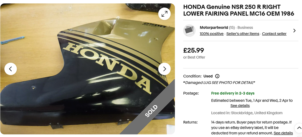

I have both at home as I bought a cheap MC16 panel for a bit of plastic “cut and shut surgery”

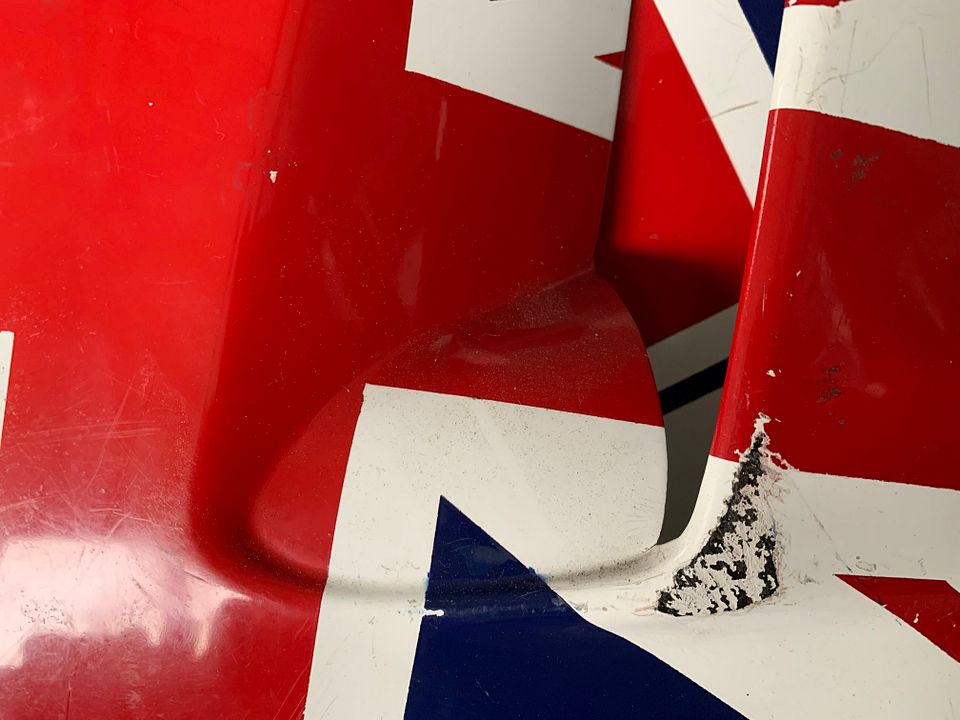

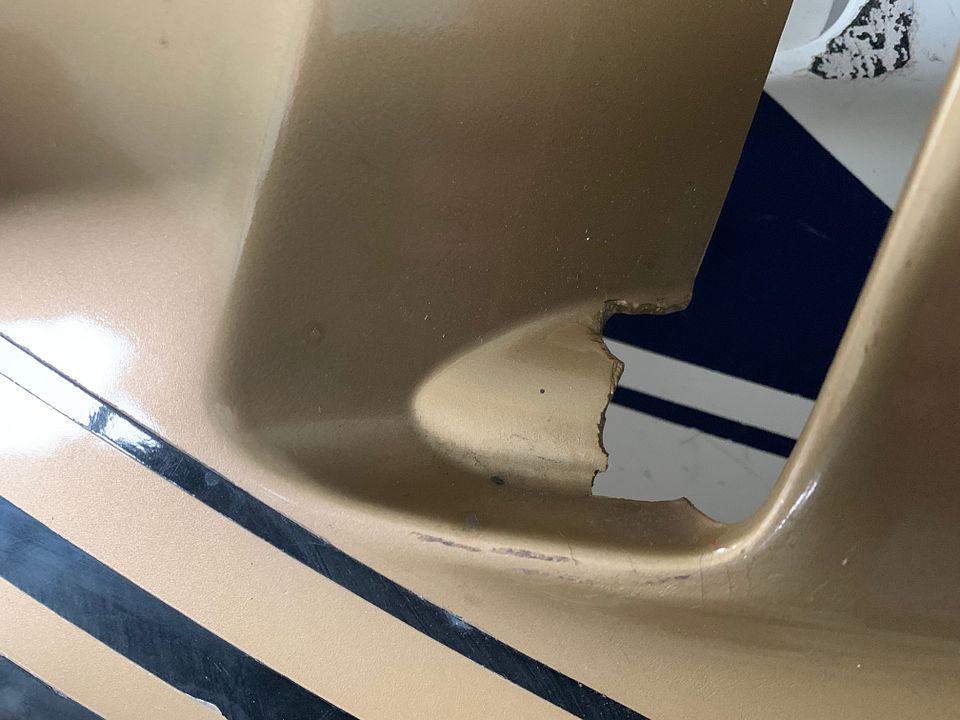

Forgot I had these on my phone but will do a better comparison over the weekend
The only difference I can see is this cut out – clearly the MC16 won’t fit an 18 as the water ducting is too small but going the other way 18 on a 16 should be fine
I will also check the screw holes for frame mounts

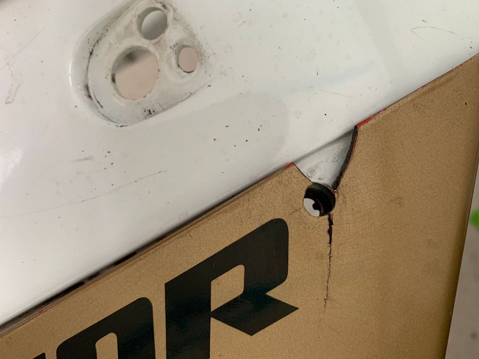

Thanks for those, my main concern is these three holes up here.
The other stuff shouldn't matter that much in this case since I pretty much assumed that the mounts will have to be custom made, since the frame that I'm using is quite different from NSR250

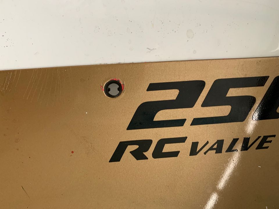

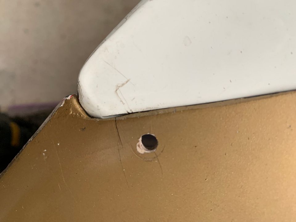

Sat Mar 29, 2025 5:50 pm » Post: #6 » Download Post
Here you go buddy - It’s a perfect match
IMG_5886
Middle hole
IMG_5885
Front hole
IMG_5887
And just for the absence of any doubt – I own an MC18 and here is the MC16 panel I bought that’s held up against the MC18 top cowl
