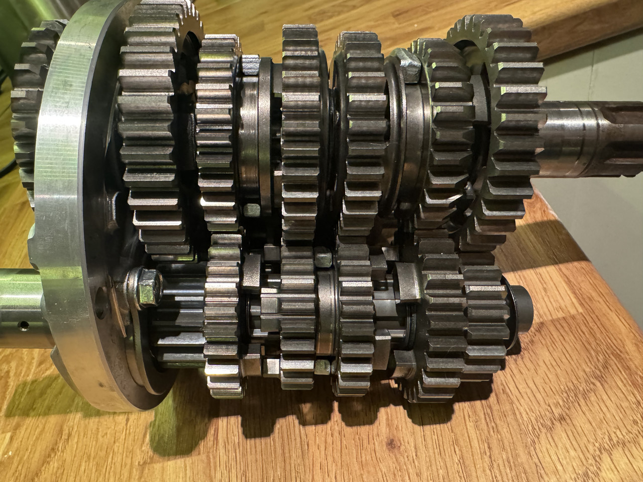

so I made the decision to take out and see if there were any obvious issues.
With the transmission out again, I noticed the left shift fork was an NF5 one 24213-NF5-710, however the centre and right shift forks are KV3. looking at the HRC 90-93 set up manual the centre shift fork should be 24213-NF5-710.
from my very limited knowledge would or should the transmission work with the KV3 centre fork shift selector?? (just answered my own question!! having a look at the parts list for an 87 NF5 the right & centre shift forks are KV3)
any suggestions as I'm at a lose atm!!
