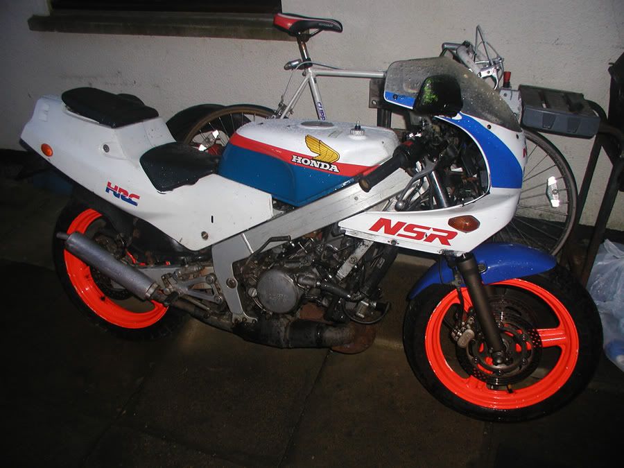

Bought this pretty cheap to be honest, but the back pot had typically seized.. think some smack head had owned it last so probably didnt use decent oil!
first day home..
I bought some mc18 barrels, pistons, carbs etc to replace the shagged mc16 items, found some tyres and got it to the mot station..
After bribing the tester it got a valid mot, so went for a run.

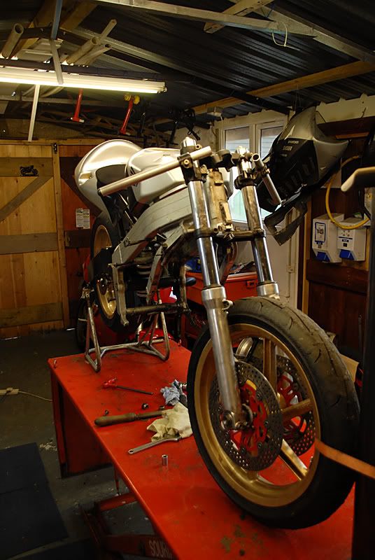

Anyway, todays task was to get the front end on. The forks are mc18 items.
The old mc16 front end
Forks and old stuff off
mc18 yokes fitted. Not a bad fit really
Still some work to do, need to get a new set of taper rollers. On the shopping list for next week or tomorrows stafford show Cool
Forks and bar mounts on
Nice new alloy bars fitted. Handy to have as spares for when the inevitable happens! Cheap too, off a well known auction site Laughing
Wheel in... mmm sexy!
Next up will be tackling the rear end, fitting the mc21 swingarm has presented me with a few problems as regard to the linkage setup.. I'm going to have to just experiment with different linkage and spring combo's until I get it right. I could, at a push modify the swingarm, as I really need to use the '21 one to get the pipes tucked in! Still, so long as its made of metal I can bodg..err modify it !

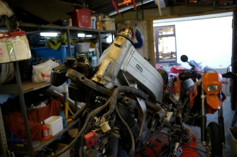

Is that your house/shed ? There seems to be a shat load of other bikes and cool stuff in the background.
Is there half a ducati sitting on the floor in the first shot (yellow bike) ?
Winning isn't everything, but loosing isn't anything
2Smoke
Posts: 827
Joined: 18 Mar 2006
Location: Isle Of Anglesey
1987 Honda NSR250 MC16
Fri Oct 23, 2009 6:47 pm » Post: #8 » Download Post
Alright mate, yes its my shed out the back of the house. Built it last year, would have been lost without one!
The yellow thing is a blata copy, watercooled thing. Revs like buggery and goes like stink but so unreliable!
The garage gets full of stuff pretty quick!!

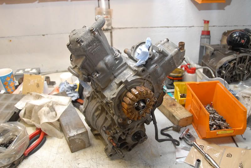

This weeks task has been to get the engine out for some tuning work, as everyone knows the mc16 cases are very restrictive, and comparing them to the mc18 cases I have confirms a few physical differences. Also the barrels are having a makeover too, try and eek a few more ponies out of the bugger...
Some pictures of the slow progress...
getting the engine out..
Quite a peach of a lump really, easy to strip the whole engine down with it in situ. Makes lifting out so much easier. I am starting to see the difference between the nsr engines and the rgv's..
L/H crank seal been leaking by the looks of things..
Big end about to fail I wonder? Look at the difference in rollers between this one
and this one
I have a spare luckily.... Embarassed

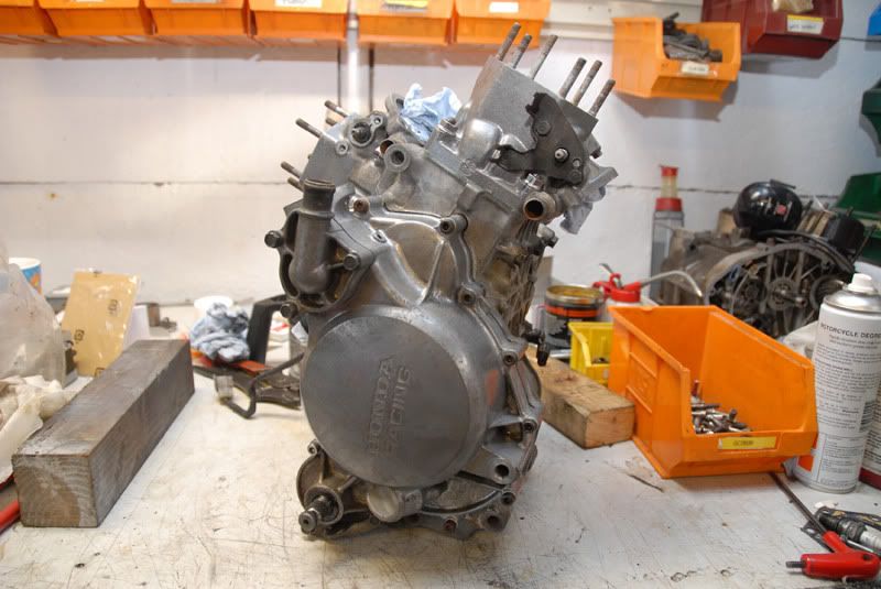

A small update...
After the weather "chaos" my engine got stuck in parcelforce world for a few days, having been nicely flowed and ported by a very nice man indeed! A call to tyga (wonderful people) got me a very comprehensive top end rebuild kit at a price I'm still suprised at, even with the postage!
So after a failed start this morning (heater ran out of gas) I finally got on with the job of putting the motor together.
Crank in..
Pistons in their place
And the rear cylinder fitted
I would have got more done but I took the time to remove the rc valves and clean behind them, plus cleaning up the gasket surfaces took a while.
Should have the engine completely built by the end of the week (time permitting... as usual) and the frame is going away for a small weld, after that happy days, get the engine in, pipes fitted and welded and we are making progress!!
