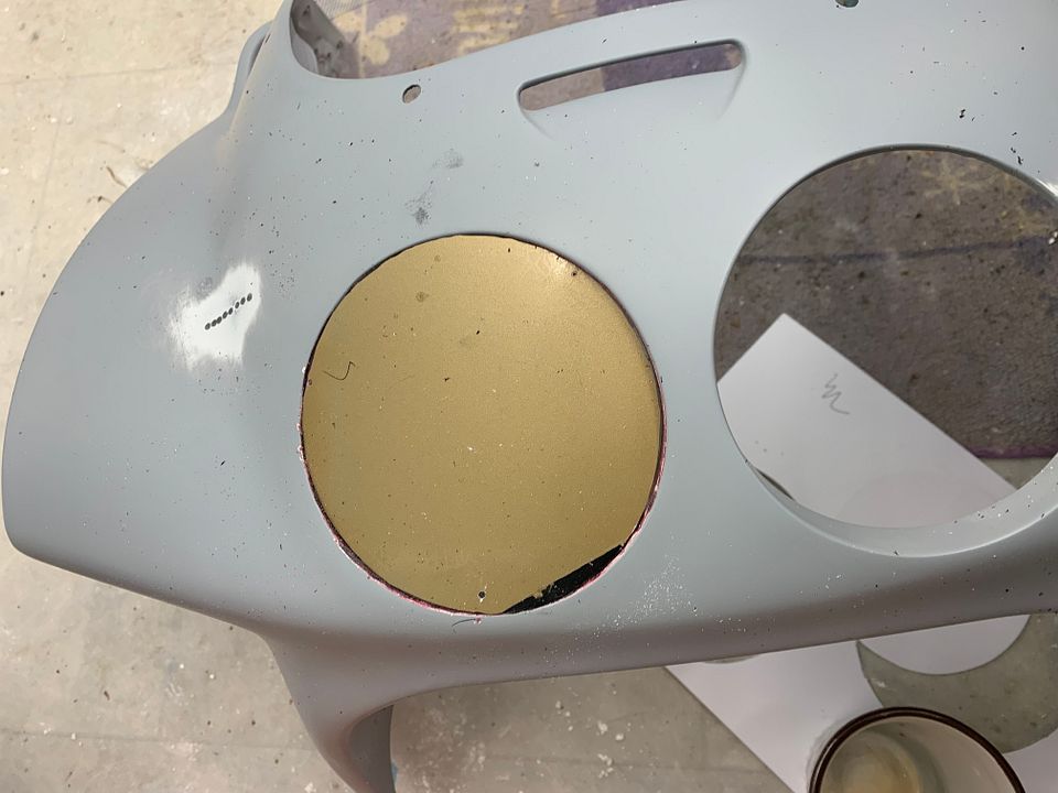

Thinking about my plan I’m not sure I’ve got the skill or patience to pull off a 50/50 and even then it might look a total Dogs diner, so perhaps safer and wiser to go with a full HB version on both sides. Legally I’ll be fine with the adhoc colour change as DVLA and the logbook show “Colour – Not Stated”
Before I can start I need to finish off my side project which I need up and running for the spring, the other half passed her test this year and now riding a 650 and I really want to ride the North Coast 500 in 2026,
NW500

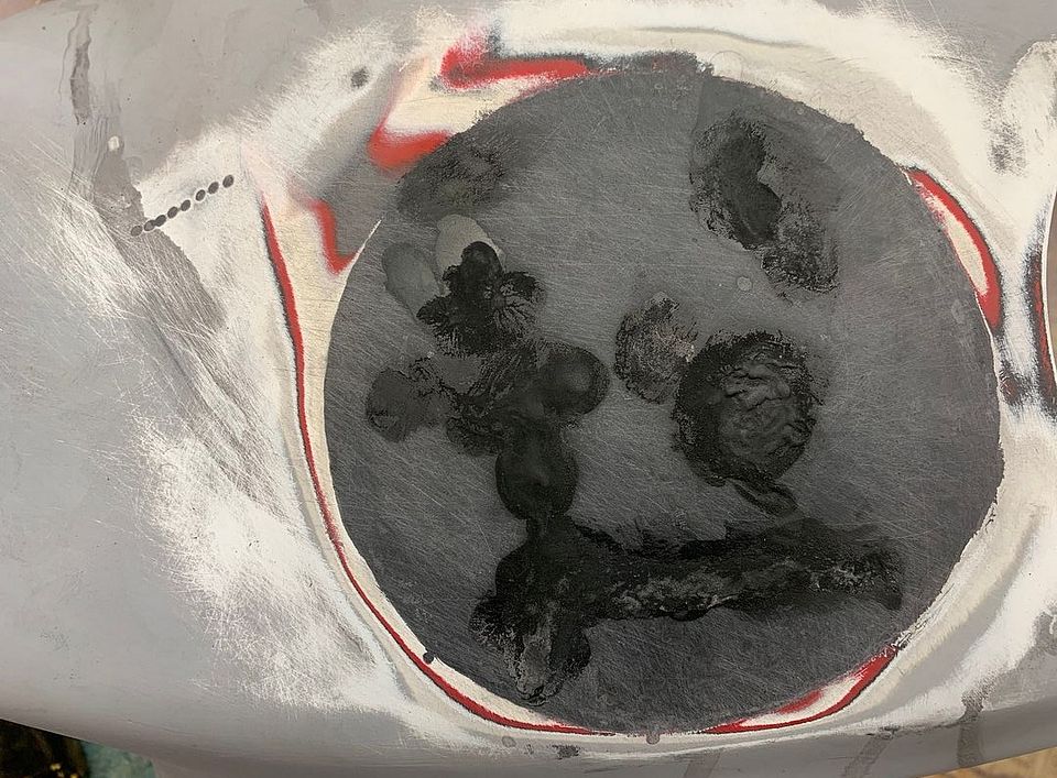

As much as I’d like to do it on the NSR its just not got long enough legs for the distance involved, so sold my soul to the devil and bought a retro four stroke, my ultimate bike being a late 90’s SP1 in Lucky Strike or Cabin livery, but for the time being settled on a late 80’s ZXR with OK to tatty bodywork so my plan is to turn it into a “Kawasaki France” inspired endurance racer similar to what Hislop/Foggy and Rymer won the Bol’Dor on in 92. (they also won at Spa and Le Mans that year)
To achieve that I need to blank off one of the two front headlights so that a number plate board can take its place, which called for an old OEM NSR panel to be chopped up and permanently bonded in using Plastex which is the same stuff as both panels are made of so seamless and permanent joints are easily achieved.
Taking the plug from a curve in the NSR panel meant shaping was reduced to a minimum but even so I still used a fair bit of the Plastex granules to obtain the desired profile before skimming over with the lightest amount of filler
IMG_6876
IMG_6875
You can see the evidence of the plastic ruler I used during the shaping process in order to get the desired profile

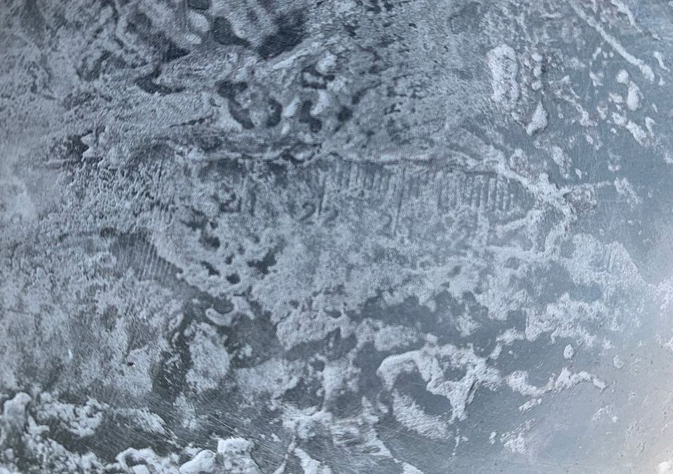

027efb4e-2834-41a6-89b6-a3c9748f74cf
And then after an initial sanding and a blob of filler (yet to be fine sanded) it close to primer
79dd31f0-f384-4dd0-b0e8-6a259845e5cd

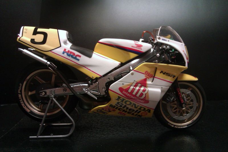

Did I misread your post? I thought you meant doing a second set of bodywork, but if you're thinking something like the BAR Honda F1 car, where they did Lucky Strike on one half, and 555 on the other, that would be epic! Very Happy
Such a great pic that ^^ have to ask whose is whose ?
Ref mine your spot on Andy- I would like to achieve 50/50, I have a full set of spare OEM Rothmans panels just encase I have an off. and then an extra set for messing with that came off a race bike and survived pretty well all things considered
In essence - One side MacKenzie in Fully HB Livery
Niall Mackenzie NSR500 HB mask decals (4)
And the other side Gardner in Rothmans
89390082_896206307483469_8100999827170525184_n
