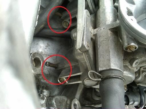

I just finished rebuilding my motor...put everything together and had a fuel leak...upon inspection i found 2 nipples on the carb not connected to anything...
Does any one know where these hoses connect to?
Pictures of the correct connection would be great!

Ok...searching the forum...seems like these nipples are for the carb overflow and I might have a float level issue...
Time to figure out how to check that now...

yeah they are the overflow outlets. Hook them up with a hose that runs down to just behind the rear brake pedal. There should be a clip there for them.

I've had this happen twice on various NSRs. Both times it was because the needle which shuts off the fuel to the float bowl wasn't fully closing.
You'll need to disasemble the carb, remove the floats and needle. Then clean out the area where the needle seats with a cotton bud (Q Tip) dipped in brass cleaner (Brasso). Both times the seat had become a little corroded or covered with crap so wouldn't allow the needle to seat properly/shut off the fuel. Spent about 15mins on each one......worked a treat
It's a fairly simple operation, even for me Shocked , so good luck.
