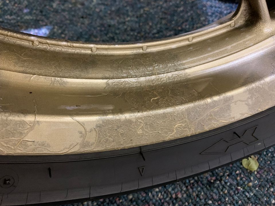

As you can see in the pictures the worming which started within 6 months of getting them back from GT performance and I believe it was Griffs in Bristol who did the work however as you can see the resulting worming is so severe I can only assume whoever did the work must have treated them as if they were plain alloy rims rather than Magnesium – sure as hell wasn’t the British climate as they started worming out long before the bike ever hit the road.
The pics below are of the dirty front wheel however the rear which is already off the bike and stripped down is just as bad so will try that one first as the bearing have been knocked out of it already.
IMG_5158
Every time I clean the bike this much worming makes me seriously twitch, With whats going on under the paint it could actually be terminal for the rim (hope not)
IMG_5159
Doesn’t matter how much you rotate the wheel its everywhere and even discoloured the paint so there isn’t a good or “better angle” to be had.
IMG_5156
And how they should look – Fair play this rim is 35yrs old so there are people in this world who know what they are doing and I know its original as its still got the OEM decal by the valve stem that’s worn away with age (either that of its one hell of faux)
So just encase and for future reference, this is what the front rim looks like in Nov 24 complete with Cold November rain (drops)
IMG_5160

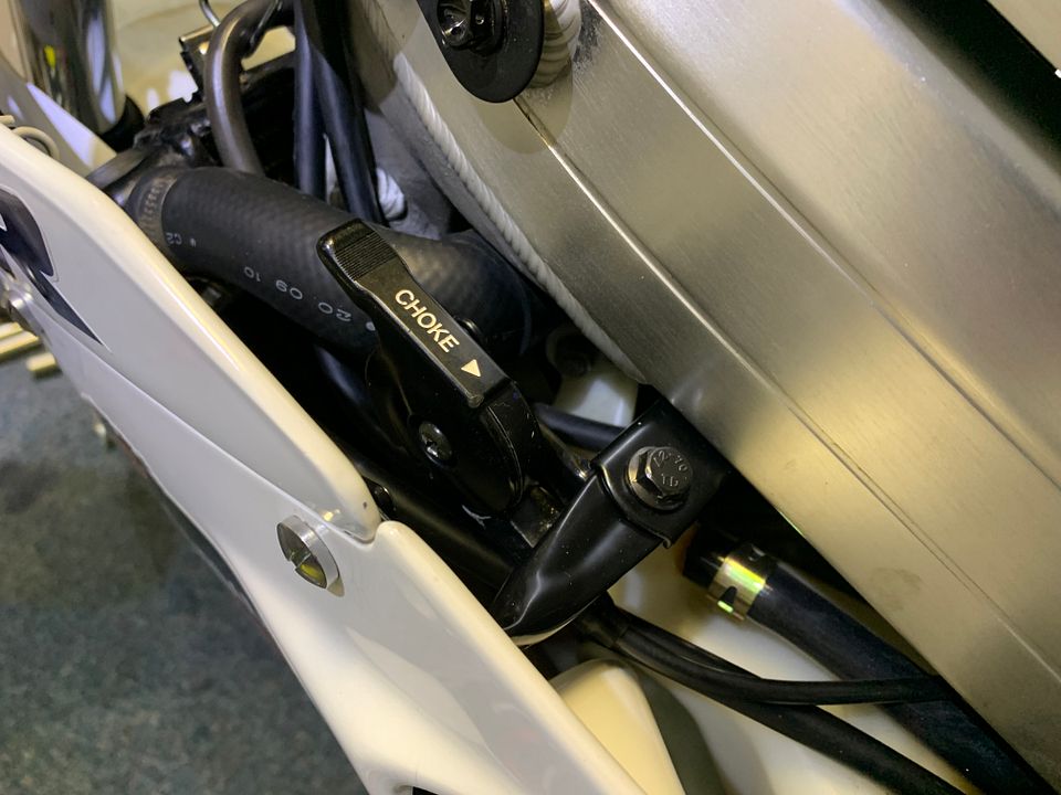

Replacement Choke lever was a lot easier to fit (this one’s not been bleached grey by the sun and still has its white lettering in situ) not new but after months of searching the best to be had and I’m happy with it.

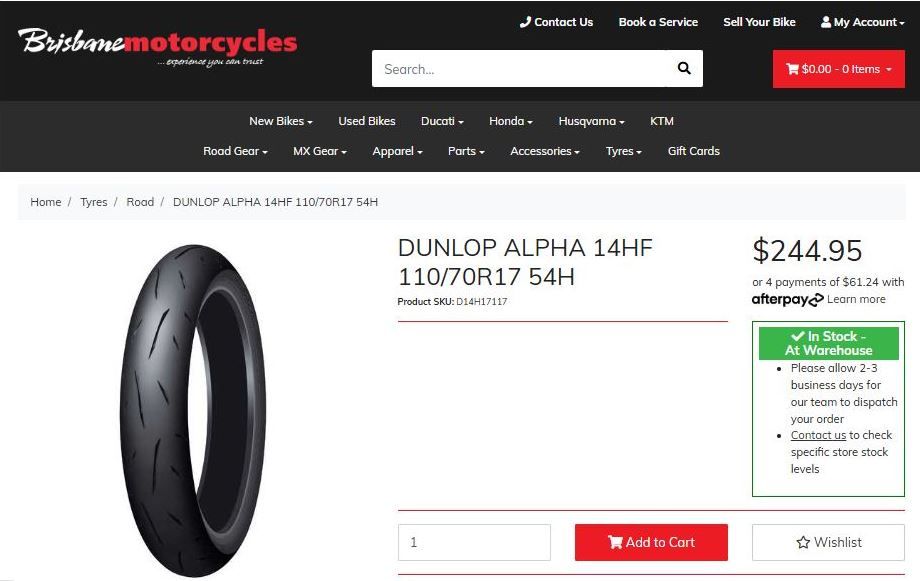

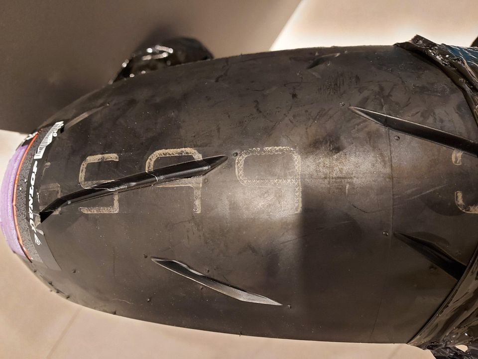

Tyres finally turned up from down under, two fronts from Australia and a rear from New Zealand – dreaded import duty as been duly paid. My carbon footprint was never great and must be shocking by now and progressively getting worse – so much so if you’re reading this in 2075 surrounded in every direction by water or your sitting in baren dust bowl all I can say in my defence for contributing to Global warming …..rather like a glamourous women “she looked good, smelt great and turned heads whenever we went out and took a lot of maintenance and was suitably indulged”
IMG_5395
The Trinity – and future proofing myself given my riding style seems to knacker front tyres

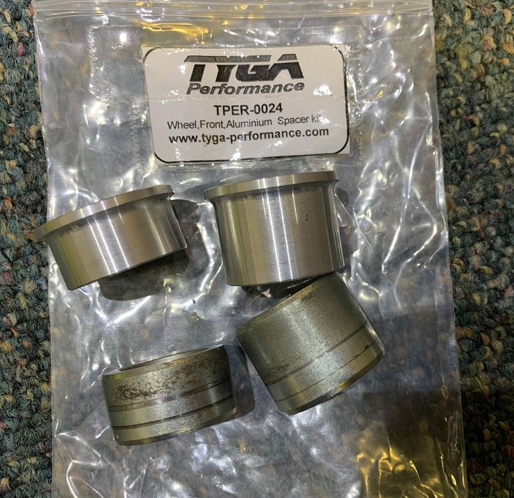

Couldn’t resist some new spacers from Tyga to go with new front Magtex rim.

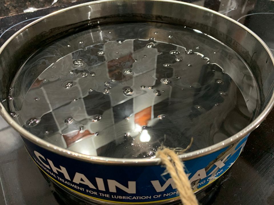

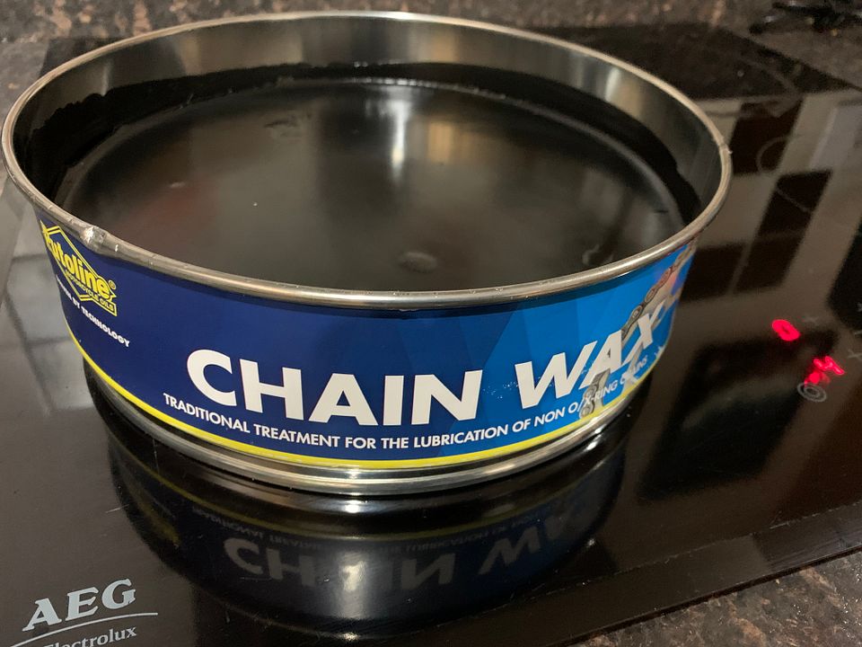

The chain has been removed and thoroughly cleaned and de greased – being a non O ring chain I thought I’d try hot chain waxing as an alternative to chain lub, purely on domestic health and safety grounds I had to wait until I had the house to myself to use the hob, the dishwasher has also been similarly been called upon in the past for its cleaning abilities.
IMG_5405
After dropping the chain in the wax bubbled like hell for a good 30 seconds as it penetrated deep into each link, I left it in its hot bath for a further few minutes before pulling on some rubber gloves and lifting it out and cleaning off the excess. Took ages to cool down and chain went quite stiff, how long the wax lasts remains to be seen but chain feels nice and smooth and hopefully won’t fling grease onto the rim.

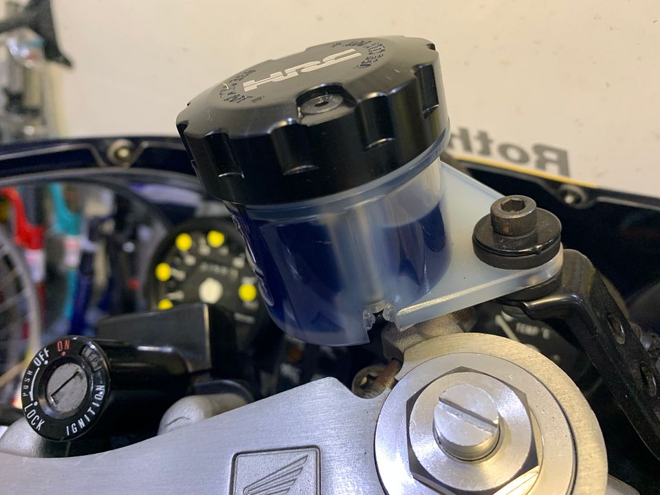

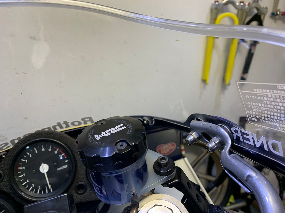

Whilst messing around and purely for cosmetic reasons I bled the brakes and replaced the brake fluid with ATE Super Blue so the reservoir is now properly colour co-ordinated to the rest of the bike.
IMG_5418
Personally speaking I think it looks good … certainly better than a reservoir filled with fluid that looks like Iron Bru or that very special yellow Coke that truck drivers seem to bottle and through out their cabs!

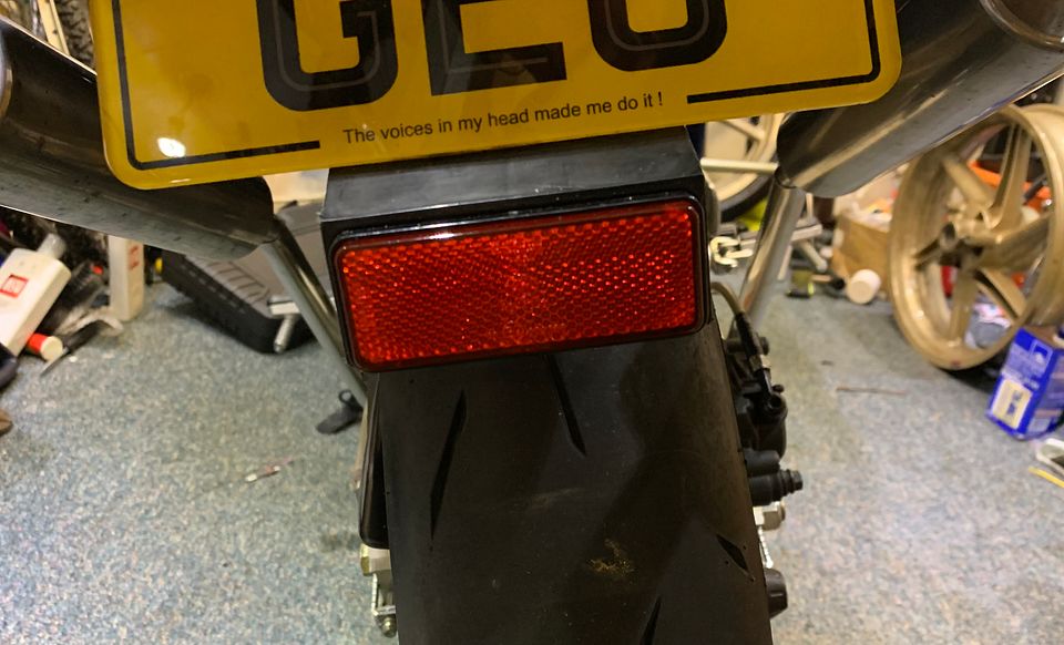

The rear mud guard /under cowl with the uncut reflector was last on the list, but once removed gave me generous access to clean the rear shock and linkages. Not sure on the final look, looked cleaner and more minimalistic without the reflector but seeing as it took so long to fit, it won’t be swapped back anytime soon. Without going silly the new number plate just about fitted in the space allocated purely for the Japanese domestic market ones.
