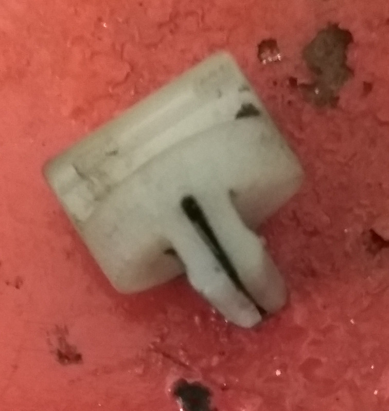

Mon Aug 09, 2021 2:44 am » Post: #7 » Download Post
Dear, Wayne
Just look your posting, herewith picture from your post, this white little thing
Thanks
Tue Aug 10, 2021 10:07 am » Post: #8 » Download Post
Is this the part?

Wed Aug 11, 2021 1:32 am » Post: #9 » Download Post
Dear, Robh
Yes correct
is this exactly 90 degree between front and back?
Wed Aug 11, 2021 7:41 am » Post: #10 » Download Post
Yes. I can take a better picture and get dimensions if it helps?
I couldn't see a part number on my parts guide

Tue Aug 17, 2021 3:40 am » Post: #11 » Download Post
Dear, Robh
Sorry just make sure, so the angle between left and right connection are 90 degree (carb side and TPS side)
OK Thanks for the information.
For the size no problem I can calculate by myself in my carb & TPS.
thanks
Tue Aug 17, 2021 4:31 am » Post: #12 » Download Post
Yes, 90 degrees
